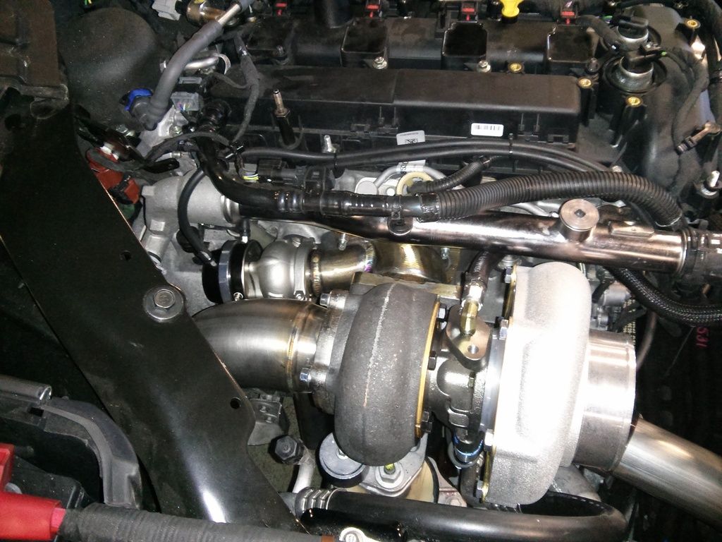

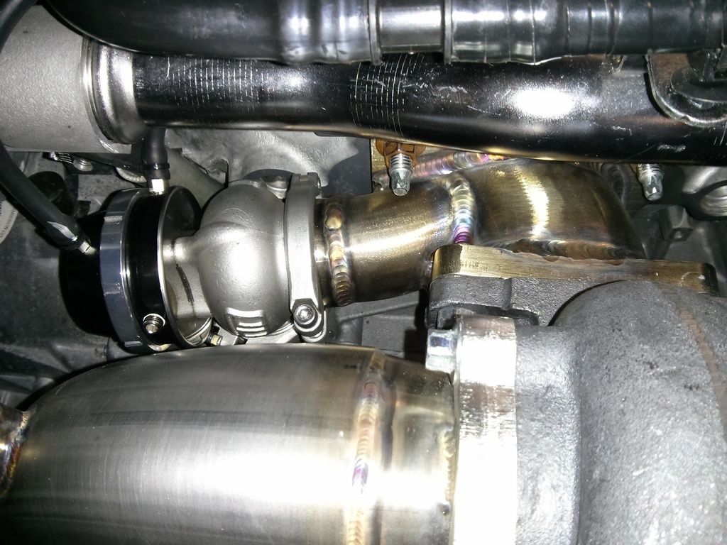

Got some work done on the turbo kit today. Almost have everything buttoned up with the exception of the intake, and mounting the BOV. Other than that, it should be ready for the rollers
Here you can kind of see our adapter flange. Similar to the K series engines, the Ecoboost does not use any real type of exhaust manifold. The stock turbo is bolted directly to the cylinder head.

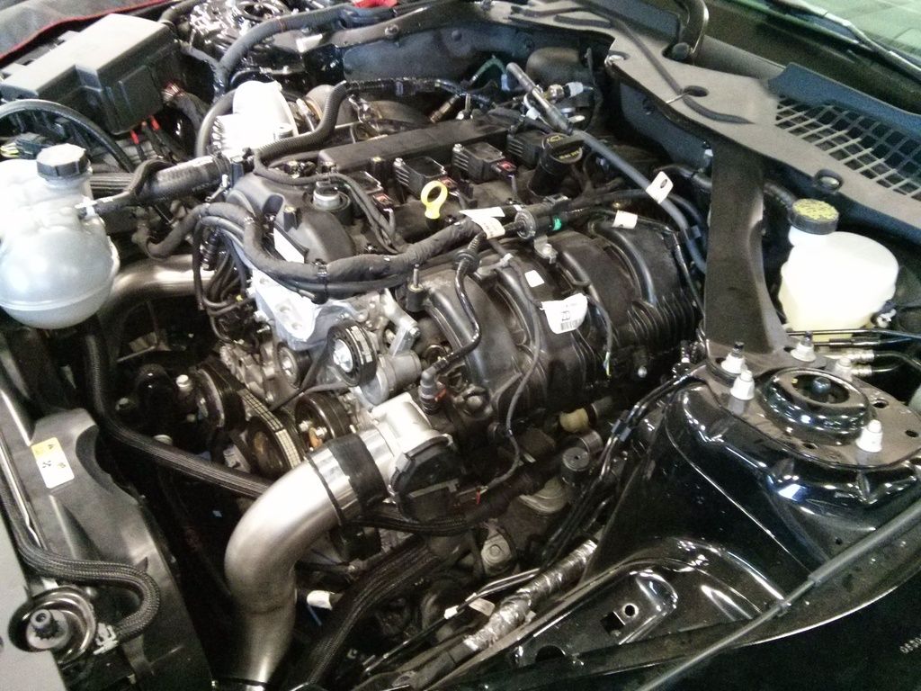

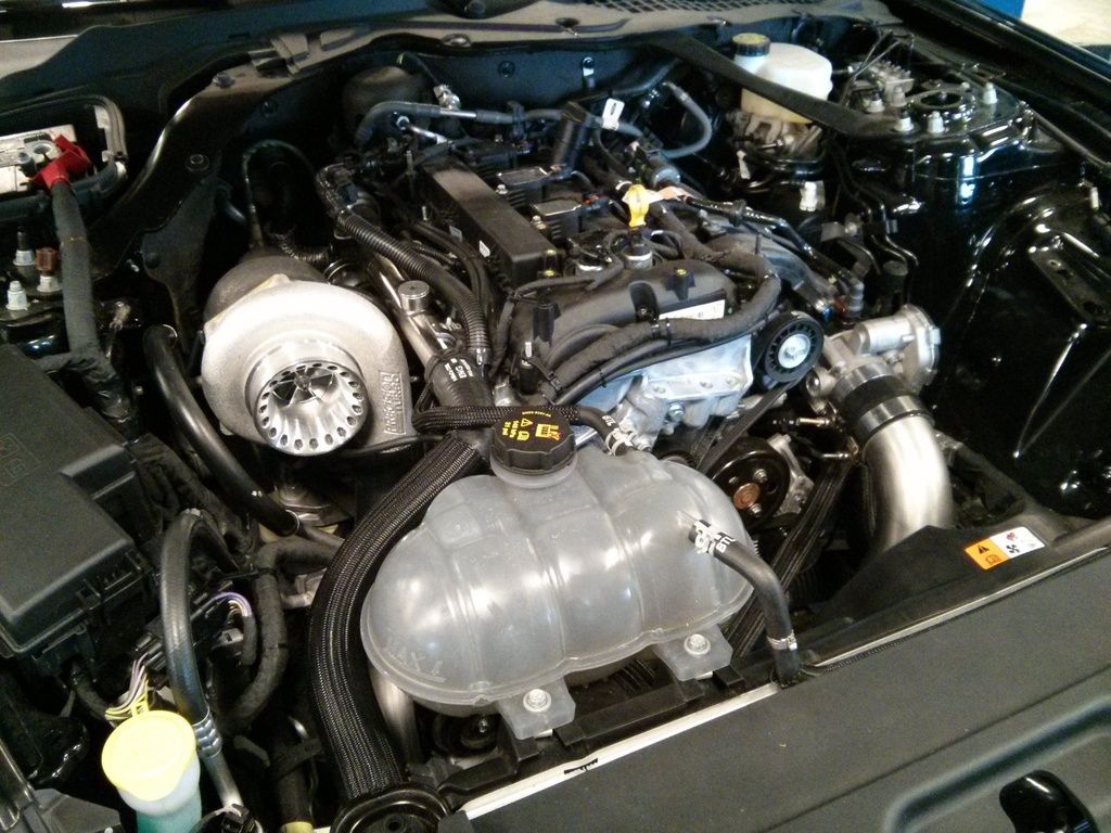

And here are some updated pics of our turbo kit!!! We will be tuning throughout these next few days. I will make sure to update you the results
