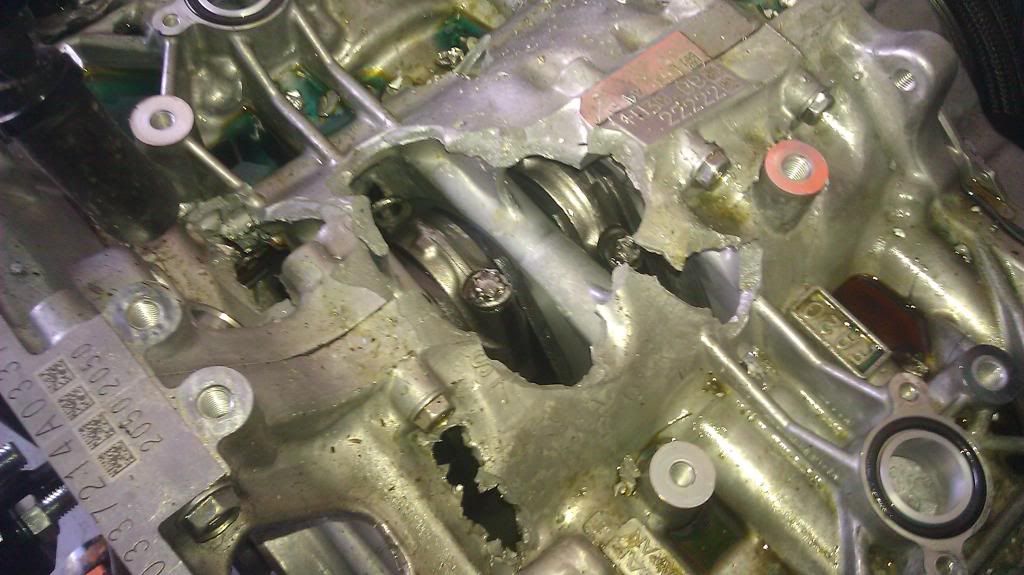

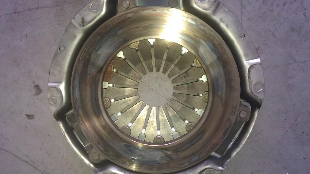

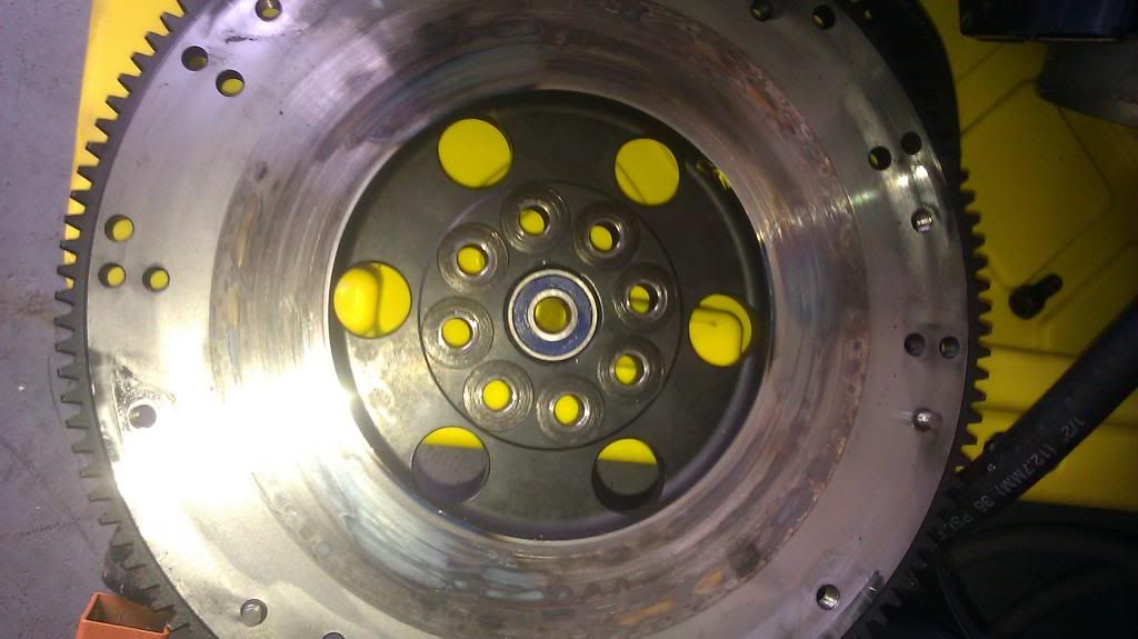

Little more damage inspection...smh
FEW HOT SPOTS ON THE CLUTCH AND FLYWHEEL BUT NOTHING UNCOMMON WITH AFTERMARKET COMPONENTS
