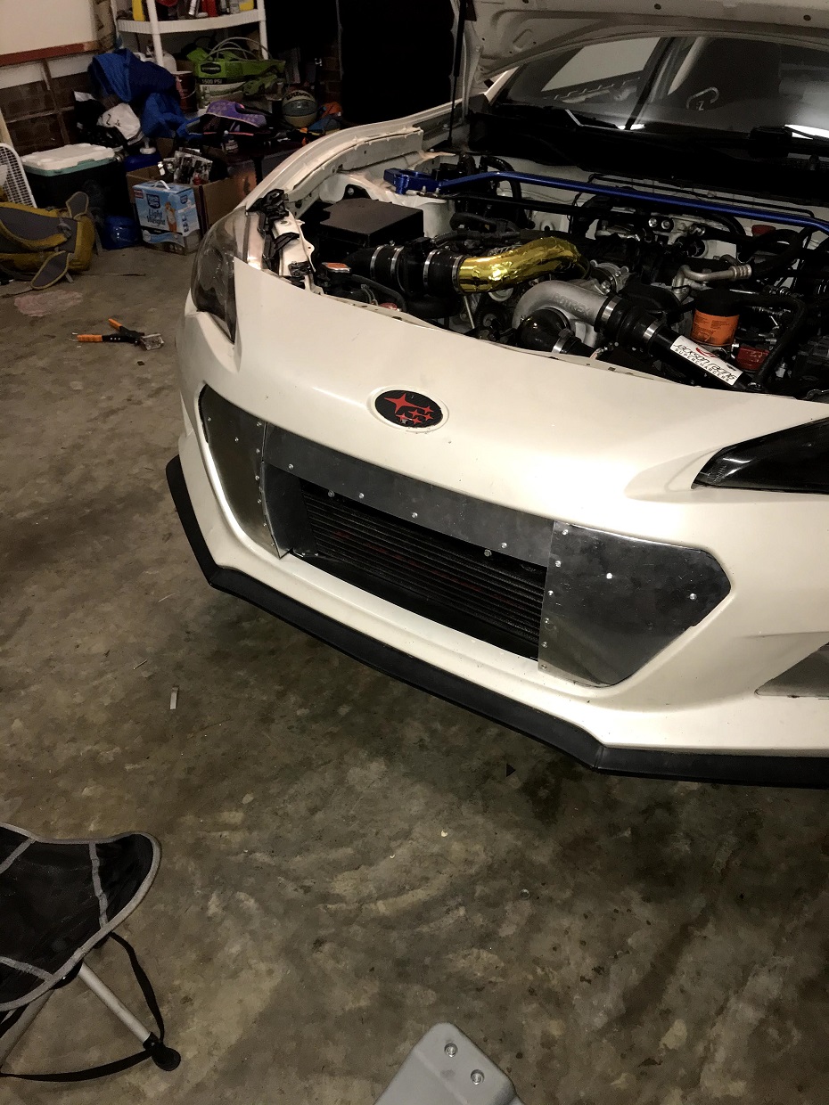

I blocked(is that the right term) in my cooling stack this week. spirited driving with 50f ambient temps I was seeing about 202-204f oil temps. Today it was in the upper 60s, and oil temps sat around 192-195f. all .025 thick aluminum sheeting.
Attachment 183706
Odd choice for ducting
Old 12-24-2019, 09:00 PM   #806
ML
ML's Avatar
Drives: 13 White MT FR-S
Location: Gastonia, NC
Posts: 1,848
Thanks: 980
Thanked 1,156 Times in 529 Posts
Mentioned: 41 Post(s)
what are other people using? ABS? This is probably lighter or as light, and I enjoy working with aluminum.
The design more than material. I used aluminum myself. Usually a cone from the grill directly to the radiator blocking air from going anywhere except the radiator is how it's done. I'm not trying to shit on you, if it works, it works
Oh ok gotcha. Yeah it’s hard to see but that’s exactly what it’s doing. Everything is blocked except for the path to the intercooler and everything behind it. I just didn’t angle it towards the middle and instead just a 90 angle. This is my first time making a piece like this So it will probably change once I get it on a track.
I went back and inspected your picture further. I didn't realize it went back in towards the radiator. My mistake. If you want more air, you can delete your mustache and get a drift bar to replace the stock crash bar. The sides of the grill that you covered I filled with scoops for my brake ducts if you would prefer that space to be functional
