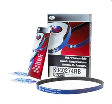

Originally Posted by sw20kosh View Post
If I wanted to have a spare belt or two what belt and where would I go to get one?
[ame="http://www.amazon.com/Gates-K061015-Multi-V-Groove-Belt/dp/B000C2YCXM/ref=wl_it_dp_o_pd_S_nC?ie=UTF8&colid=3R25DPLAMKZAD &coliid=I1730Q9ERKMUCY"]Gates K061015 Multi V-Groove Belt : Amazon.com : Automotive[/ame]

This or the reinforced version. I would stick to Gates brand but other brands like Goodyear or Continental are likely just fine as well.

Originally Posted by evo4g63 View Post
The belt supplied with the kit is the standard belt not the reinforced correct?
I believe this is correct. The reinforced one is the blue one.
Link: [ame="http://www.amazon.com/Gates-K061015RB-Blue-Racing-Micro-V/dp/B000TTILZI/ref=sr_1_1?s=automotive&ie=UTF8&qid=1375814426&sr= 1-1&keywords=K061015RB"]Amazon.com: Gates K061015RB Blue Racing Micro-V Belt: Automotive[/ame]
Yes, the belt in the kit is the standard version which should be just fine. The blue reinforced belt costs about 3 times as much. Keeping a spare belt and some basic tools in your spare tire well would be a good move even in a bone stock car.
