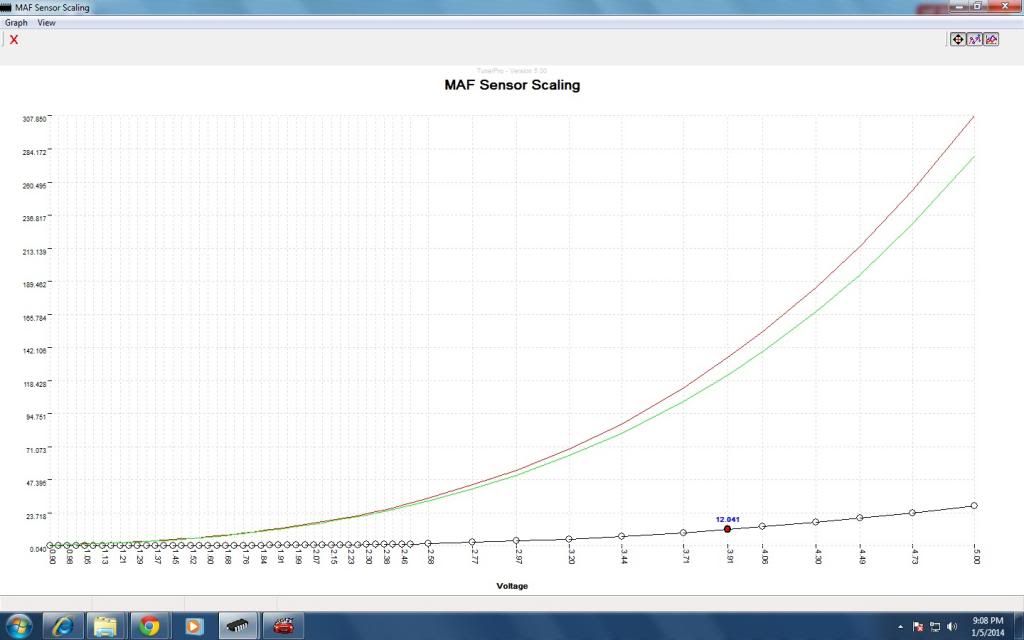

Here's a graph screenshot of the original maf scale compared to my modified maf scale:
No lumps or bumps anywhere.

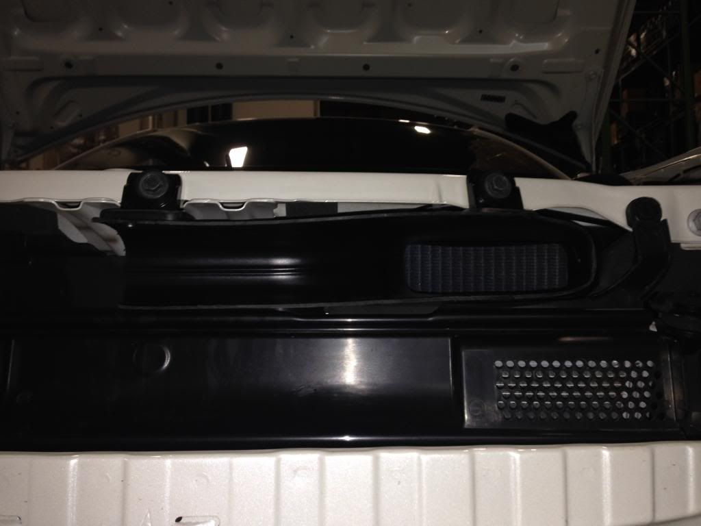

And what I did with the snorkel:
