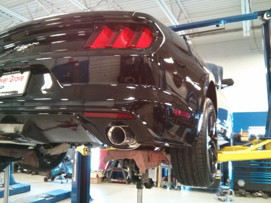

Started on the exhaust today. We should have our dyno video up of the Accessport later this week as well

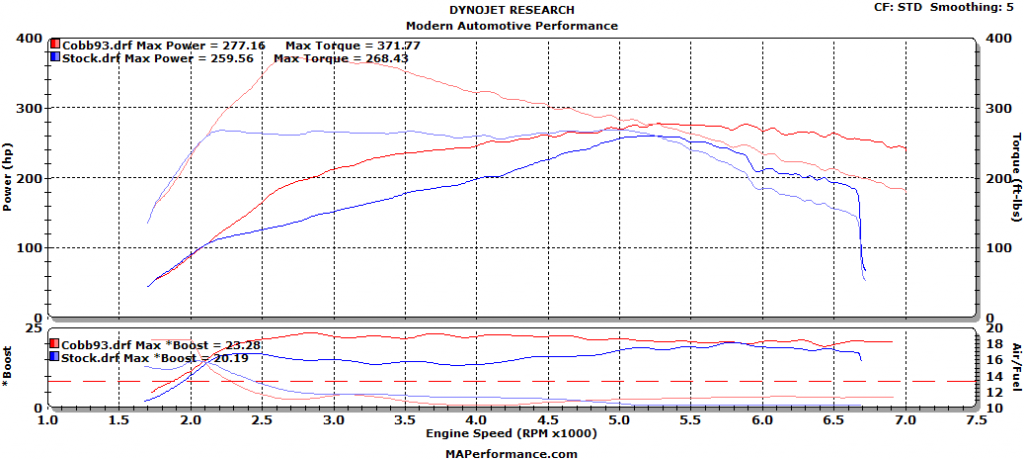

Cobb AP dyno
Hey guys! Finally got the Cobb Accessport installed and did some testing of of their maps. This was all done on stock everything. Not a lot of top end power, but does keep it from dropping off compared to the stock tune. But noticeable gains in the mid range for sure! Not a big difference between the 91 and 93. We will see what we can do with our custom tune soon.
91 Oct tune:
93 Oct tune:
Stock run vs 93 Oct:

Wow, almost 374 wtq with just a tune, that's pretty impressive.

wow these things are really tuned down from the factory, can't wait to see open exhaust results.

Torque monster for sure. I bet with our downpipe and exhaust coupled with our custom tune, it should be over 400wtq.

That's a lot when you consider the displacement of this motor. To put that in perspective, my '08 GT500 was making about 470 wtq and that was a 5.4 liter SC motor!

Impressive torque. This might be a dumb question but here goes. Why does the curve decline after 3000-3500? Compared to the stock curve which pretty flat.

Most likely do to the fact that this turbo is simply pretty small, and it has a hard time holding large amounts of boost at the higher RPM range. Great for instant spool and good low end torque, but doesn't make great top end power. Our downpipe and catback might help with this a bit, but we will see.
