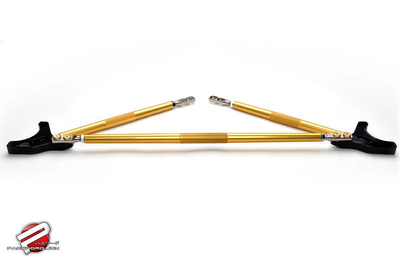

What advantages are there in adjustable strut bars?
I would imagine the usual load on the struts would be in compression?
If so you could fit them and then preload them, in extension, against that compression, to keep the structure very rigid.

Alright, here we go, your Monday morning update!
No way!! If it doesn't cost $102.47 I'm not buying it!
This.
Personally I would prefer plain black, no logo. I appreciate from a marketing point of view this might not be the best option for GrimmSpeed. I have the Perrin intake fitted and have put black tape around the tube over the logo. I have tried to peel it off to no avail. I prefer the look of a plain under bonnet/hood, not cluttered with 1/2 dozen different brand names.
I really really like the look! Stark functionally.
Maybe something as simple as a clip similar to this would be sufficient. Perhaps where the coolant hose passes through would need to be rubberised to stop flex wear. Just a suggestion.
Sounds like we're on the right track with the design and branding and that clip is very similar what we had in mind! We'll definitely get back to you guys for more branding feedback as that becomes a priority!
Originally Posted by sierra View Post
How about making all 3 bars in aluminium with the rear bars bolting to the front bar mounting? That will mean plenty of stud to allow for a strong[thick] strut mounting bracket and also keep freight down because the 3 bars can be packed together.
Have you weighed the front bars?
A small weight gain for beautiful curves is always acceptable to me.
Thanks for the input! Believe me when I tell you that we've done a great deal of research regarding what's available and what our material/design options are. From there, we create a set of requirements for our design and on this project, we decided that those requirements are to produce a bar with zero sacrifice in function but at a very affordable price. We'd love to design a 'baller' bar, and perhaps sometime in the future we will, but for now, we're looking for maximum performance without a high-end cost. For that reason, the bar will likely be welded steel construction, similar to what's been shown so far.
Originally Posted by RazBRZ View Post
I would like to see you make the triangle bars. But keep them separate, as an option and or a completely separate buy altogether. Also I run a Crawford AOS, So keeping with the OEM look with similar mounting is important for me. Other than that, I like everything you stated above and I can't wait to see what happens
Great input! Seems like a lot of people have interest in the separate triangle bars. We will definitely do some digging to see how the performance benefit compares to the cost and let you guys know what we find.
Originally Posted by s2d4 View Post
Are you talking about a stick on part? people can slap it on or leave it off if they want?
What do you mean more beautiful?
We'll definitely be hitting you guys up for input on the branding of the product when the times comes, don't worry! I think that what Chase meant by more beautiful is that if a few extra bucks (literally) gets you a more aesthetically pleasing part in your engine bay, it's probably worth it. Nothing major, just nicer brackets, etc.
Originally Posted by u/Josh View Post
Did you do any deflection testing with your bar alone (stock triangulation bars removed)?
I'm not sure if Chase has any 'official' data on this, but I know he did some testing. The testing that's been done so far has been so that we can feel good about spending the time and resources to move forward with developing the product. As part of that development, way more testing will be done.
Curves<->Woman=Good
Curves<->Tower Brace=Bad
Originally Posted by dawnst3ar View Post
So, I know NOTHING about tower braces, but so far, I like the direction you are going. A larger bracket would be on my wish list, along with red to go with all the other Grimm stuff in my bay. Personally, in the limited research I have done, my favorite was one that had a bracket that went all the way around the hole in the tower.
Thanks for the input! We really do appreciate everybody's opinions. Why on Earth anybody designs and develops a product with input from the people that are going to use it certainly makes no sense to us! :happy0180:
Originally Posted by SkAsphalt View Post
I love the look, may I suggest you make a nice 4-5 inch wide grim speed gold plaque (like the ones included with your hood struts) to be placed on the center middle of the brace?
why? because sexy
Added this to our branding ideas chart!
Originally Posted by Jeffboyarrdee View Post
After reading the input and GS's direction, I like that this is going function over form...well in this case form makes all the difference but you all get what I mean. I think that if the tests show hollow vs solid makes no huge difference, then hollow it is! If creating new triangular bars be non beneficial or even add a significant increase in price this may not be the best direction. Even small engravings or textures can add to the price. I think that their goal of a very very affordable and yet reliable product is marketing in itself that would separate from the rest. I'm excited for this!
Right on! You think a lot like we do!
Originally Posted by knipple View Post
As long as the Grimspeed bar remains a 2 point bar, as in only connects the strut tower bars, this bar will be legal for STX. If the Grimspeed bar ends up being a 3 point bar (e.g. replaces the bars that connect the strut tower to the firewall and is integral to the strut bar), it is no longer legal for STX.
This bar is NOT legal for CS though.
This is the reason that we're going to keep the triangulation bars separate for now. In the future, I could definitely see having both a 2pt and 3pt bar or three separate bars. We are certainly mindful of autox guys!

We've definitely thought about this. What we came up with is that a 2-in-1 bar/mcb requires a performance sacrifice on both, and we're not down with that! Who knows, maybe in the next few weeks we'll come up with some new ideas and that'll change!

Originally Posted by Clembo View Post
Has anyone contacted the design engineers about the original analysis for the stock triangular bars? What, if any, were the original requirements for the stock triangle bar installation (preload, strut tower position, point at assembley, etc.)? And what were the fastening requirements? When I see mounting studs intentionally painted after fastener installation I assume there was a torque requirement. And does this torque stretch the mounting studs as it does in some cases? If so, these studs may require replacement before reusing them as attachment points. And depending on the new loading forces and directions, they may require resizing as well.
I'm not questioning your present analysis or data, only that without knowing the original parameters, you may be unintentionally altering some of the original design assumptions and/or criterior. I see people yanking parts off their cars all the time (and often replacing them with something else) with little thought as to how or why they were put there in the first place. In most cases and for street use, it probably doesn't matter much. But for the track or extreme conditions it may be a different story.
Sorry for being over-cautious but I come from the nuclear world where engineering often took a huge number of variables into consideration. And without a solid understanding of all these variables, it was easy to get in trouble.
I'm originally from the defense industry, so I know what you're getting at here. There's obviously a long and short answer to this. The short answer is that getting a hold of the right people at an auto manufacturer is nearly impossible and beyond that, getting answers from them is even more difficult. Our job is to do what we can with the information that we have. Aside from the fact that TRD used the same mounting points, we have a shop car and a product like this will typically see at least a few thousand miles of use before we're even close to releasing it. If there are issues, you can bet will coax them out of the design prior to production.
Originally Posted by Shankenstein View Post
It's a valid concern that painted bolts indicate QC procedure. Typically, we use a colored dot to denote loctite (blue, green red). A line (swipe) with a grease pen is used to indicate final installation. Once the part has been installed and torqued, the line will show if the bolt backs out or if maintenance has been performed. Perfectly lining up the mark after maintenance is more work than most techs care to do, so it's a good indicator. If the bolt is realy at risk of backing out, cotter pins and safety wire will be used. You won't see many of these on cars (besides the axles), because it's cheaper to overdesign.
As far as reusing the mounts, the factor of safety on those bolts is insane. In single shear mounting, bolts can handle ALOT of force. Most of the load is shared by the structural pieces you're connecting. The reason an engineer would overdesign them, is when the nut walks out... the force is no longer shear (in plane), it becomes bending (out of plane). Strength drops alot. You have to design around bad mechanics and neglectful high schoolers. If everything is tight and properly aligned, you could probably hang the car from those 4 bolts.
Here's a question for ya'll. Have you ever seen a broken strut tower bar? It doesn't happen very often. When they do though, it never happens on the bar itself. Failure is many times due to over-tightening of bolts or shock loading causing failure at a weld/bend near the mounting plate.
The gussets on the GS bar mount seem to be pretty robust in that regard. Not too worried about them finding real estate for a logo either... everything they fab up has G*S etched/laser cut in it.
The bar will see both tension and compression in use. Often and unfortunately, the adjustment is there to pick up any slack left by poor manufacturing or design. If you properly tighten down both mounting points for the bar, the bar will not slip back and forth and there's no need to preload the bar. Another reason for a multi-piece bar would be on an older chassis, were it's been tweaked enough that a tight-fitting bar won't even install. Not an issue with these cars. We have a lot of cars come through for testing of various products and more often than not, multi-piece bars are broken, loose or missing hardware. We'd like a 'set it and forget it' installation.
Matt
Engineering
If it's steel I doubt I will buy one. Aluminium alloy will achieve the same rigidity for less additional weight and that factor is critical on this car.
The brackets for the struts could have been alloy too. Bolting steel onto the alloy bonnet was the only negative to that kit and I would happily pay the extra cost.
