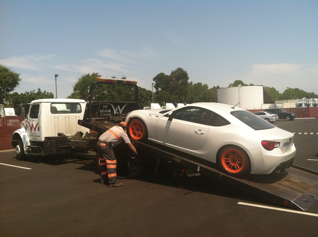

I wanted to bump this thread because I blew up my diff today!!! WOO!
33K miles, about 50 AutoX.

I'll let you guys know how the warranty replacement goes. My car is obviously an autoX car.

axles....diffs..... :/ .... all things to car that are a necessity.... what did the Diff actually do??? Gears??? LSD??? NOGO???

It stated making noise this morning then around noon today I got off the highway (cruise set at 75 for 15 miles) then I stopped and made right, then at the next stop sign I went to turn left and as I engaged 1st gear it made a ton of noise but the car had drive, then be the time I got it into 2nd it made more noise and the car lost drive.
I did notice yesterday at AutoX I had a lot more wheel spin than normal on launch, but my RS-3 are also near the ware bars...
No CEL, engine runs fine as and I can get the gear box into any gear fine. Just tons of girding noise from the rear when you try to engage the clutch in any gear. It was 100 out today so I sat it in for two hours with the A/C running to keep cool waiting for the tow.
