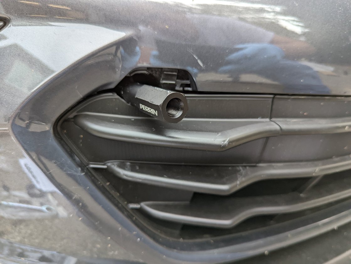

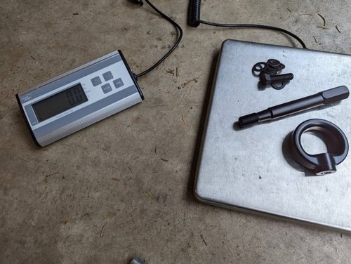

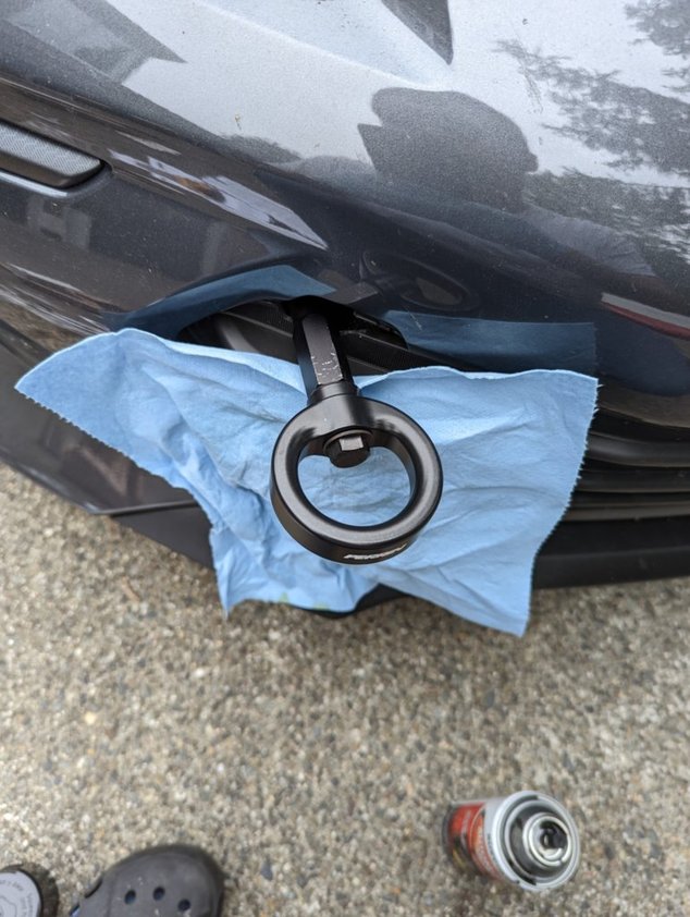

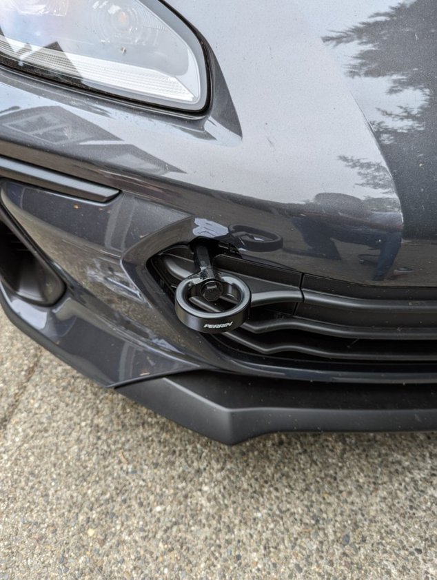

Perrin's tow hook is pretty light. I think it's a bit less than 1 lb, but my scale is not sensitive to that low of weight : P
Perrin states no modification needed, but you certainly do.
The stem of the tow hook quickly got damaged as I tightened it. I sprayed a bit of gloss black paint on it.
Well, glad that I got black. It looks a bit too big, so a blending-in color is good : )

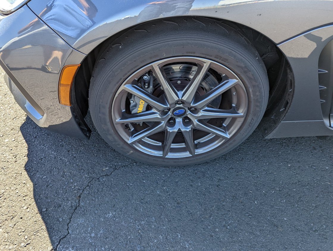

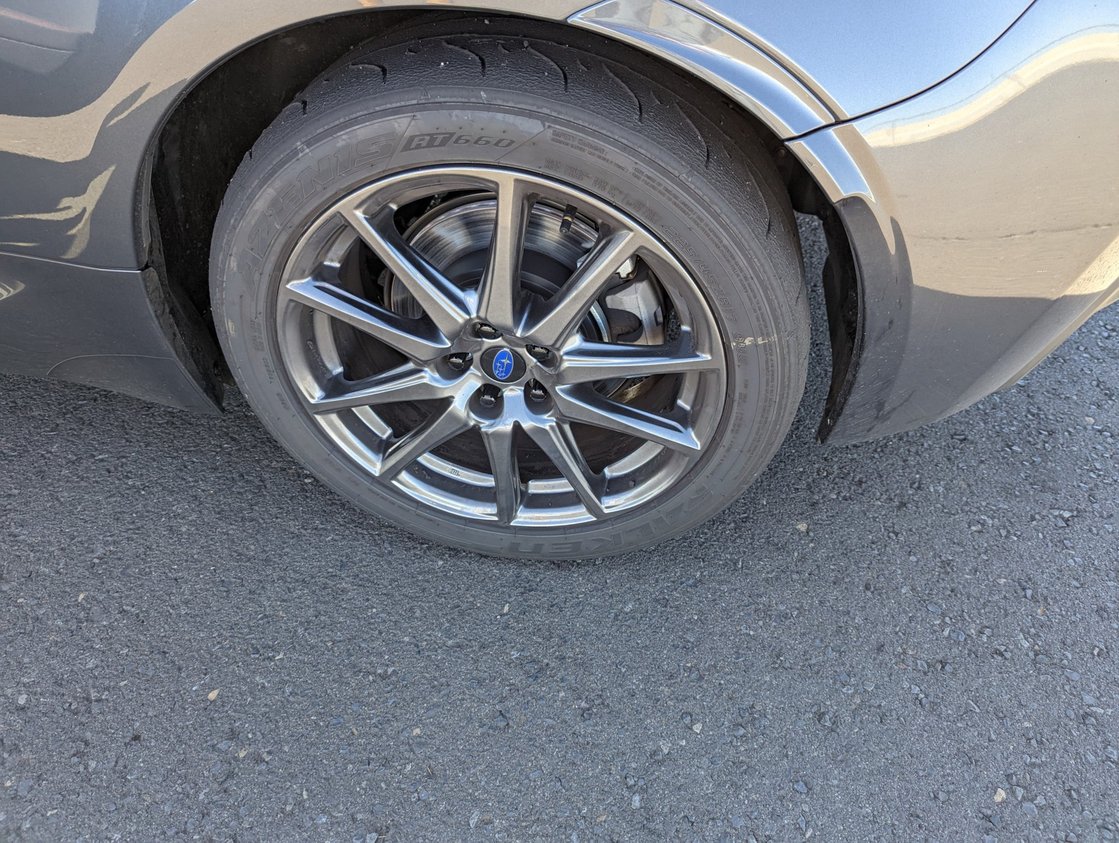

The tires seem to have had a tough life after only two track days, and I only did 1 1-hour session today. I suppose the low front camber (-2.5) that I could get from the stock suspension is not helping.
Tires spun a bit on the wheels. The white markings were aligned with the valve-stems during the mounting. We'll see what happens with the 17x9 APEX wheels, but I was surprised to see this with only 225 wide tires.
How the car looks like right now...

Love the build. Incredible the tires spun on the barrel. 5th Gen Z28's did this...Apex wheels should have those grooves or notches in them to prevent the tire from spinning.

Yeah, I used to own a gen 5 Camaro ZL1, and remember it from that time, too.
My C7 Z06 also spins the tires on the wheels despite the wheels having knurled beads already. My tire shop mounts the tires with no soap to reduce the slip, and it helps a lot. It also helps if you can wait a bit for tires to warm up before you apply hard braking (which seems to be what spins the tires on the wheels).
My next lap right after this video is cut was faster than all, pacing 2:03.6, but had to slow down 2 turns to finish due to a yellow flag and a spun BMW. So in a way, I'm sure I can extract a wee bit more, but I'm running out of time with the season getting over real soon here in the Pacific Northwest. Next time, I'm planning have the coilovers on.

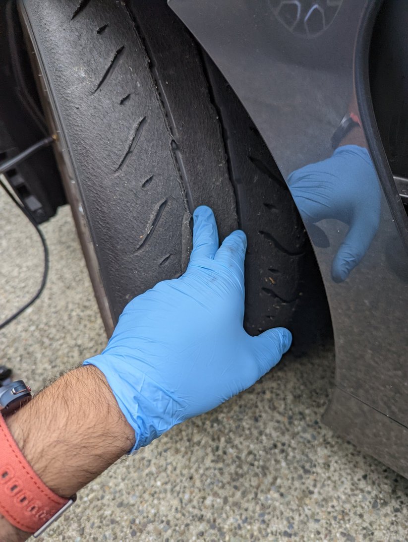

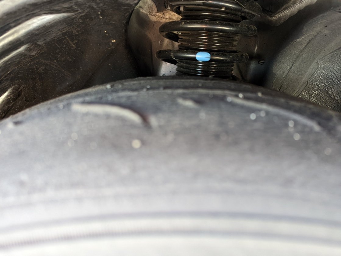

I decided to use the car for commute today, and took another look at the front tires. Looks like the driver side has worn down to zero by where I am pointing at. Considering I've used these tires for only 1.5 track days, it's quite a short life.
Anyway, stock suspension is not ideal, neither is the -2.5 max camber I could get off of these, and I'm guessing it went above ideal pressure as well during the session. In any case, we will revisit all this once I install the coilovers.

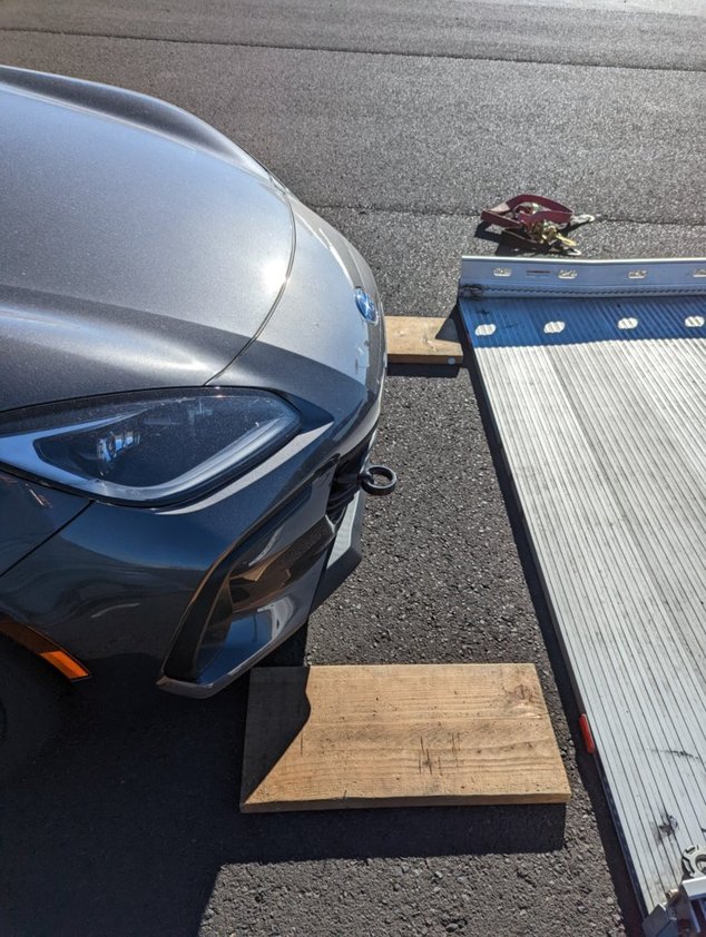

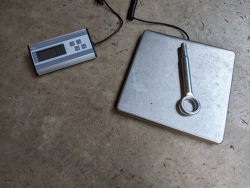

So, it turns out Perrin tow hook is not really a tow hook, or at least it's nowhere near as tough as how it should be, or how my other tow hooks are for my Corvette.
I winched my car for 1 event with the Perrin tow hook, and despite the relatively low angle of 3-5 degrees from the winch on the Futura kneeling trailer, the tow hook is bent : (
You can see how the bottom stem is bent.

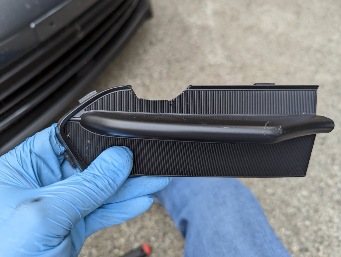

Decided to reinstall the OEM hook, but this time I painted it black first, so it'd not stick out from far.
The hole I had to carve for the Perrin tow hook-alike accessory is a good match for the OEM tow hook as well, so the install was a few seconds of twisting : )

Regarding tow hook, that was disappointing. I did not even tow the car per se, and just used it along with the winch, slowly pulling in on a surface at less than 5 degrees angle, and for such a lightweight car. Anyway, I'm glad OEM hook is not too heavy.

Crazy the Perrin tow hook bent like that. My Raceseng tow hook is fine and I’ve had to use it. I’d shoot Perrin an email.
Old 09-20-2022, 01:05 AM   #70
X25
Sr. Spiritual Advisor
X25's Avatar
Join Date: Apr 2022
Drives: 2023 BRZ Premium
Location: WA
Posts: 119
Thanks: 7
Thanked 104 Times in 56 Posts
Yeah, I sent them an email yesterday. I'm still pending their reply...
