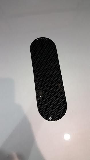

Mesh came in for the hood vents, painted it black. Still needs final glue but pretty happy with it.
Doesnt photo to well

Almost did this yesterday, but parts for the new car came in. Possibly jumping head first in the next couple days.
Did you just use a hole-saw on both ends then make a straight cut between?
Sure did, 3.25" diameter I believe.

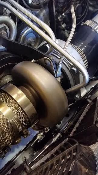

Swapped hot side to .86 AR Tial housing (Right) my aggressive wastegate strategies didn't match with the .64

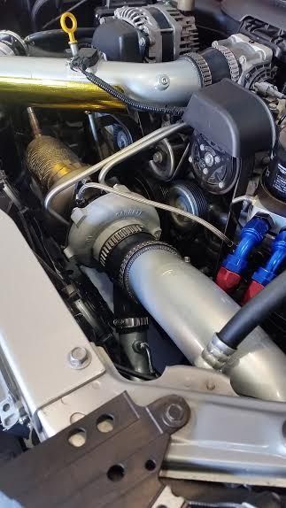

Thanked 1,389 Times in 671 Posts
Some updated shots of the .86 housing, sand blasted compressor cover, and updated upper intercooler pipe

Can't express in words how happy I am with this 28RS, the .86 housing has no noticeable increase in "lag" but the top end is much much better. Not that it was bad before but this just breathes now, probably leaving the dogs at home tomorrow so I can take this for a longer ride.
