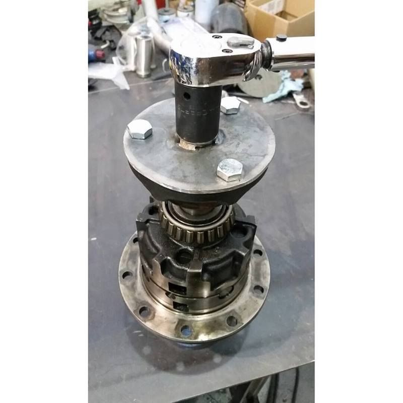

As it sits this LSD has a breakaway torque of about 53lbs on my bench rig, with a heavier spring installed it should see closer to 100 lbs. In this test the stock Torsen LSD would score 0 lbs.

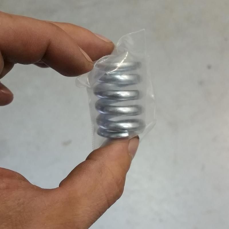

Its hard to say what the down side of top stiff would be as these aren't really categorized as 1.5 or 2 way. Mechanically it sure looks like a 2 way but being simple in design and a OE part I have a hard time believing it will be as aggressive as a aftermarket 2 way even with the spring.
When I purchased the upgrade spring from Weir I described my car and usage and this is what we ended up with.

Googling around I am seeing the stock LSD seem to be 45-60 lbs, gravel rally cars set 150-175, and drifters shimming them up around 250. So using that as a scale 45-250 I think 100 is a fair start.
Link to Weir page, I have the #1 kit
http://www.weirperformance.com/maxgriplsdkits.html

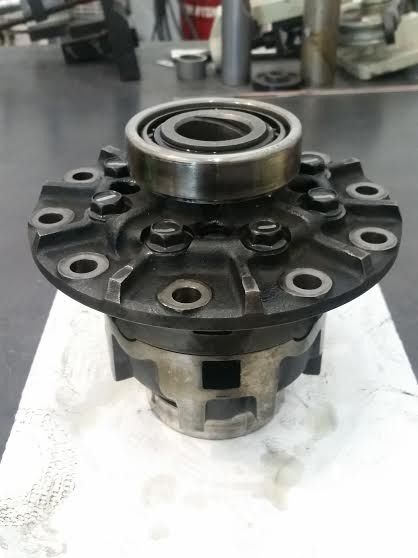

Popped the LSD apart on lunch
Pretty straight forward.

With the new spring and all shimmed up to spec I'm seeing just over 100 lbs of break away. That's also a fairly dry lsd. When it's all installed I will test again.
I'm also curious to test the break away with just the shimming as mine was pretty loose.

Tested a few different combinations. These are averaged numbers.
Untouched with no shims, 53 lbs
Shimmed to Weir spec, 90 lbs (Dry)
Weir Spring with no shims, 100 lbs (Dry)
Weir Spring and shimmed to Weir spec, 108 lbs (Dry)
(Shimming is not really intended to raise the torque but to set the backlash on the spider gears. Weir gives a spec of .004-.005 while the shop manual says .002-.0079)
Sticking with the Weir Spring and shimmed to Weir spec I then lubed everything and re-tested, 100 lbs on the nose. I'm very curious to try this thing out.

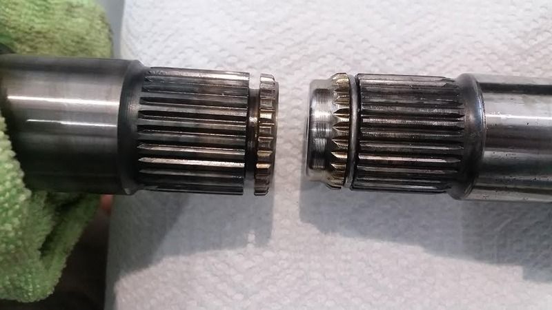

Had to shave down the inner end of the axle a 1/4" or so to fit in the LSD. Weir gave me a heads up this may happen so its easy to work out while its still on the bench. Trimmed is on the Left, untouched stock on the Right.
Only the splines to the outside of the C clip are driven so trimming where I did shouldn't effect the axle at all.
