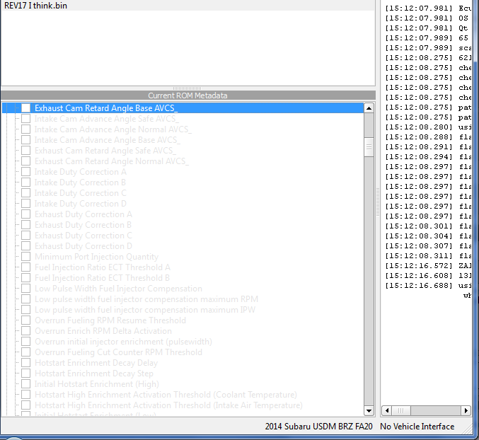

Is there a reason the AVCS tables in ECUflash for B01C are incomplete? I attempted to attach the addresses found in RR. And this is what I ended up with:
The represented numbers are about 40 units higher than the units in RR. Does this seem correct?
I'm not sure why you're trying to put them in - they are already there, but in the BRZ Alpha section.
Make sure you are running the correct 32BITBASE - as I mentioned elsewhere, I had to move the Alpha 32bitbase.xml that has all the new BRZ tables into a seperate branch, as it was causing issues for Merp with respect to his MerpMod project.
Use this one: https://raw.githubusercontent.com/TD.../32BITBASE.xml

Apologies, I got confused as to which program was being discussed. It's still not showing a BRZ Alpha section. It shows up in the Misc section but the tables are still greyed out.

^ That means it's not reading the 32bitbase.xml correctly - or not reading the right one. Check in the log text to the right whether it's actually reading the 32bitbase.xml that you have replaced.

Thanks a lot! I was trying to keep two versions of ECUFlash and it was pulling the 32bitbase from the original.
