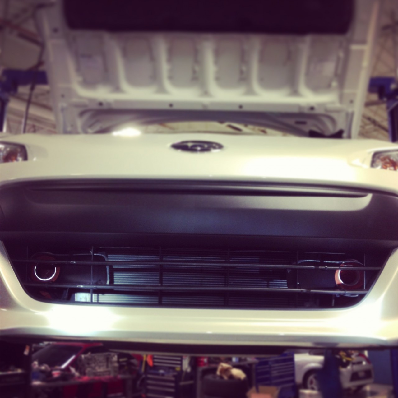

that's what i'm wondering, how's the heat exchanger fit in? i have a zeek snorkel and i'm wondering if the togue factory brake ducting would also fit.

I can only comment on my heat exchanger, which is different from the Innovate version. However, mine sits on the base/floor support of the bumper. Your Zeek snorkel would be above it, not interfering with it. Same goes with the brake ducting, which I assume are behind the fog lights? Neither would be in the way of the heat exchanger (at least I don't think so). Maybe someone can post a picture for you??

indeed that is what i am hoping
TF ducting is in the same area as well -

I thought they were behind the fog lights, but I guess not. Looking at your pictures, my heat exchanger would not fit with your ducts in that location. Someone else with the Innovate exchanger will need to chime in, since there's is different. I believe the Innovate version is a little smaller???

for reference, the zeek snorkel as well
