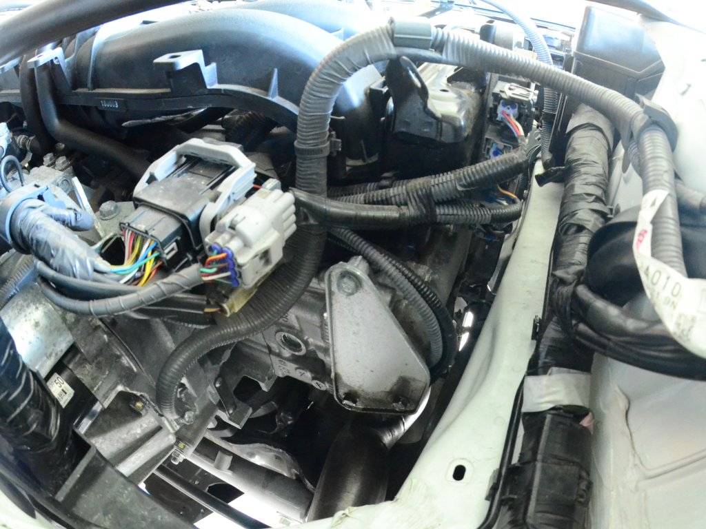

I changed my oil for the second time yesterday (third time for the car). That was the cleanest used oil I've ever seen, so I'm happy about that. I also installed the cam plate I bought 14 months ago...
Before:
After:
So if the car wasn't a chick magnet before, it will be now.
Originally Posted by phobos512 View Post
Have you seen these items @Anthony?
DI ECU Mount new from Nameless performance, saves 1.5 lbs!
http://shop.namelessperformance.com/...y-ECU-Bracket-
While I was waiting for the oil to drain, I just removed it altogether!
And while I was at it, I removed its buddy from the other side of the engine, which was even heavier:
Just those two pieces and their 4 bolts saved 5.125 pounds. Cheaper and lighter than Nameless! Not as flashy though...

So what are the items that were mounted to those pieces attached to now? Or should I say, zip tied to?
On the driver's side, you have the injector cover. It's the one that weighs 2lbs 14.4oz in the picture. Nothing mounts to it, it's just a cover.
On the passenger's side, you have the other injector cover, which also doubles as the mount for the direct injection ECU. The DI ECU has two bolts on bottom that mount to the engine, and one bolt on top that mounts to this thing. The two bolts on bottom are more than enough to hold it in place safely, so that's how it is now. No zip ties needed.
Hey awesome, you just saved me 5 lbs and $90 heh.

Do you mind taking a picture of the engine bay in its entirety I'd like to see what it looks like after you removed those covers.

Just to throw this out there; the di covers are to prevent a fire in the event of a crash. The front fenders don't take much to cave in and if they make it to the di fuel line that's alot of very high pressure fuel spray. Just saying before anyone asks what they are for and why are they so heavy.
