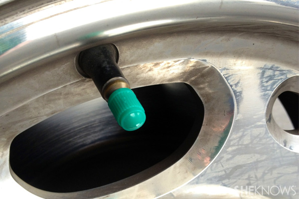

Any pics? I dont see anything green in my car....well.....anything legally green....

Edit: Easy DIY test, take one tire filled with nitrogen (courtesy of your local dealership, costco, american tire, NASA, whatever) take one tire filled with atmospheric air (stop off at a gas station on the way home drain a tire flat, fill it up with the air compressor there), let them sit in the garage overnight, equalize the pressure in the morning, let 'em sit in the sun for a few hours and measure the pressures again. You could be fancy and measure every half hour and make some nice Excel graphs, of course make sure they get equal sunlight and aren't close enough to influence each other significantly.
Might do this if I get my next set of tires at costco, lets see if they offer any trackable compounds aside from RE71R and MPSS...
Thanks! I walked around my car probably 8x's now and throughout the day looking for something green. Mine are all black.
