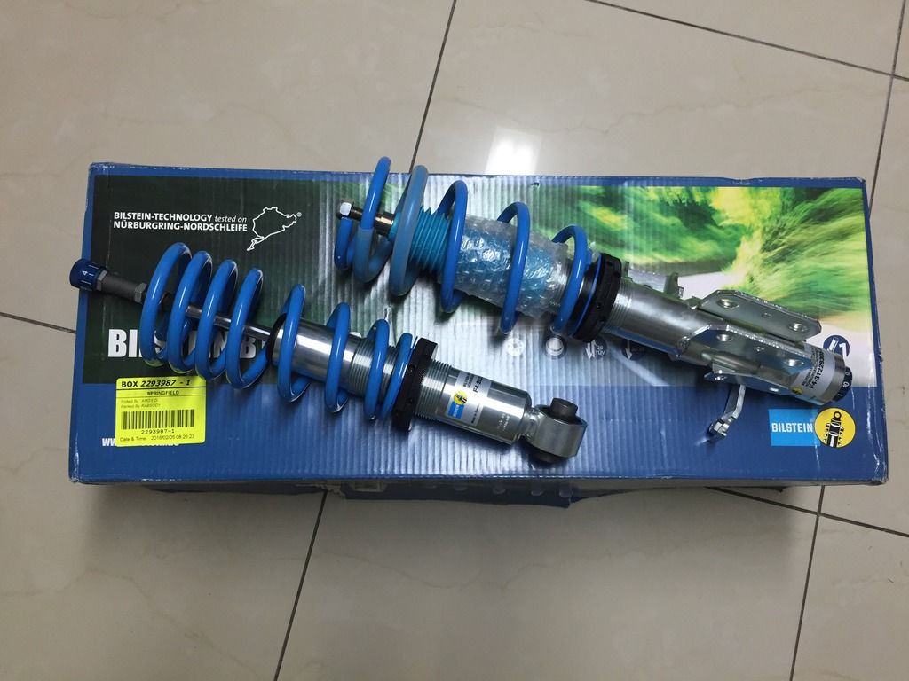

It's been a while since I posted.
I have been enjoying the car a lot... especially after installing these bad boys

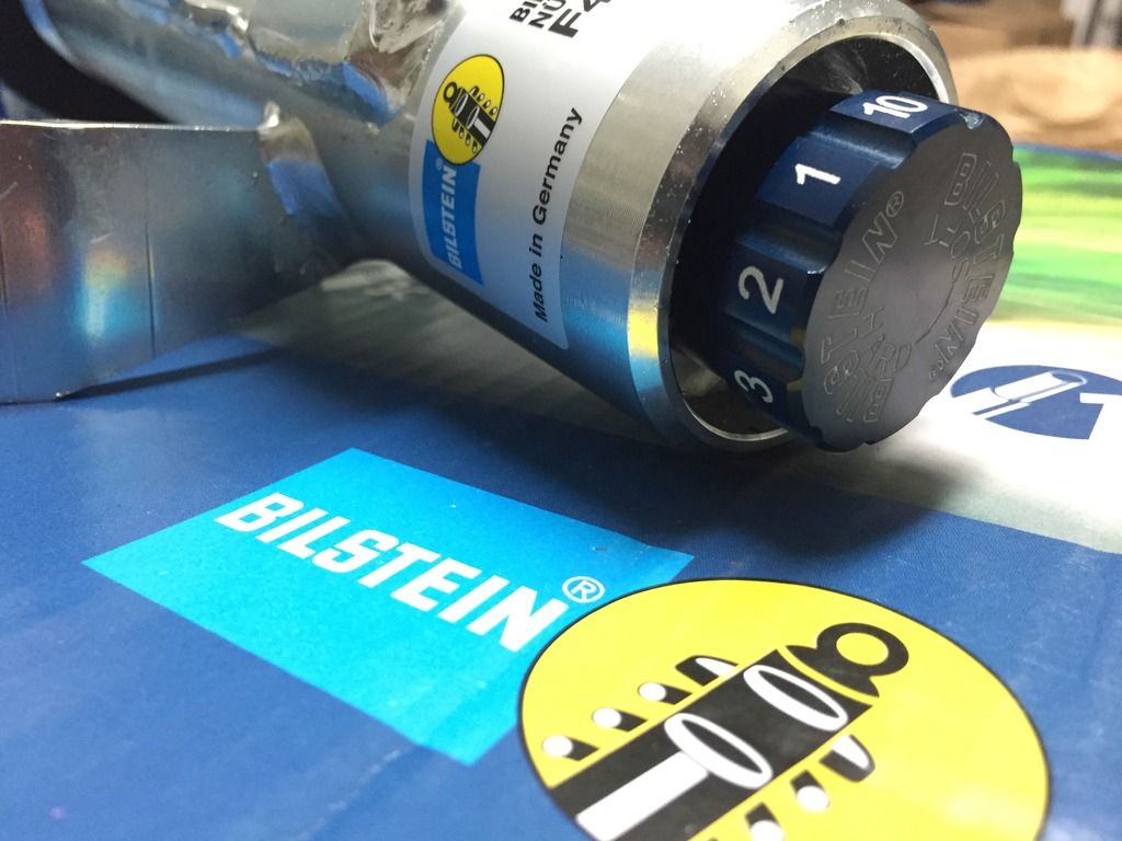

They right when you say you get what you pay for! This kit is amazing. Unfortunately the front doesn't go down as much as I was hoping for. In the picture above the fronts are maxed out.
The ride is better than stock. At the moment the front is set to the softest and the rears are half way to hard (5 clicks).
The only issue with the install was that the rear shock mountings had to be drilled. It seems like the Bilstein rear shock rod is thicker than the stock one.

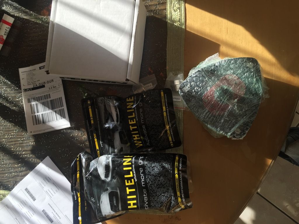

These past two weeks have been busy at work, however I received more goodies from ft86speedfactory...
I was a bit skeptical to install the camber plates as I never wanted to ruin the ride of the car since it's my daily. Installed the Velox camber plates and I honestly cannot feel the difference compared to the stock mounts.
The whiteline positive traction kit and shifter kit was also done. Car feels lovely during launch. I don't get that rear banging/shuddering when you launch the car now. The back feel really stable now.
