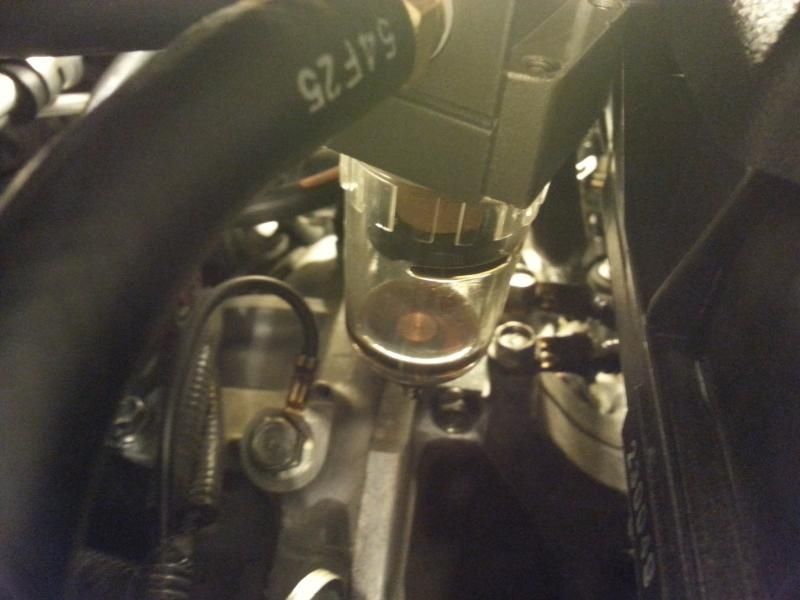

I'm pretty sure this will work..there was a bit of oil inside the oem hose. I left in the brass filter but drilled a lot of 1/16 holes on one side of it facing away from the inlet tube. I do believe there needs to be some sort of screen/filter in there. I also sealed up the bottom drain so that no oil can drip from it.
Anyway, super-simple mount. One zip tie at the eyelet on the intake manifold.

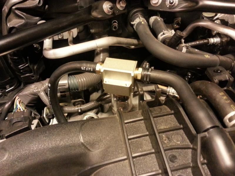

Completed my HF air-oil separator and mounted it to the triangular bar.

Looks good! I was thinking about doing the 90 degree fittings.

It's working
