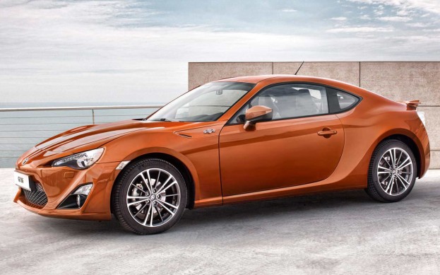

[]http://fc06.deviantart.net/fs70/i/2010/182/3/f/Fast_and_the_Furious_Eclipse_by_CSixx.png[]
[]http://3.bp.blogspot.com/-4iDSUfhlV-0/UIDH-u7xZEI/AAAAAAAAEeM/uqrlS6wL-So/s1600/toyota+gt+86-2.jpg[]
[]http://i.imgur.com/Xx8Xv2S.jpg[]
thats hot shit.
