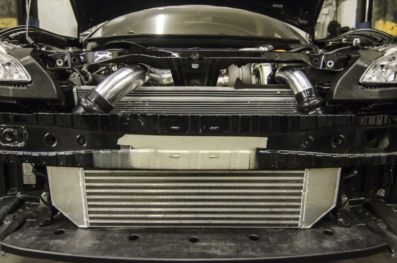

Can you take a pic of the intercooler? Plz
These are in the first post. Was there a specific area you wanted to see?

Looks like the bumper beam is trimmed. How much needs to be removed?

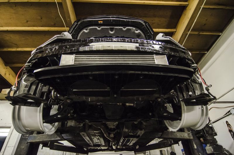

Like looking from the front of the car.

Sorry my previous reply was before coffee. Here you go
About 2.5"-3" notched out where the ic pipes pass through. Took about 15 mins with a cut off wheel. Beam is still strong and supportive. I may fab a lightweight beam sometime in the future that will work with no trimming etc.
