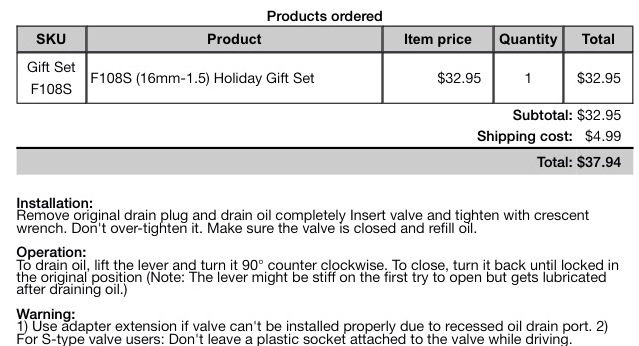

Here is what I ordered and installed two days ago. No issues so far :-)
Ordered from Qwikvalve...

I purchased mine from Qwikvalve.com and they say use the 108, although I haven't installed it yet. The sizes and applications page on the Fumoto web site appears to have some inaccuracies for both the Subaru and Scion models, maybe just dated information.

Thanks, ---Where is the 'Thanks' button on this forum? Does it only show up after a certain number of posts?
What makes it a gift set? They put a bow on it?

It had nice green and red streamers inside the box... LOL!
It came with additional stuff... Safety clip, two hose end clips, black valve cover, and a long piece of clear hose for draining the oil :-)
