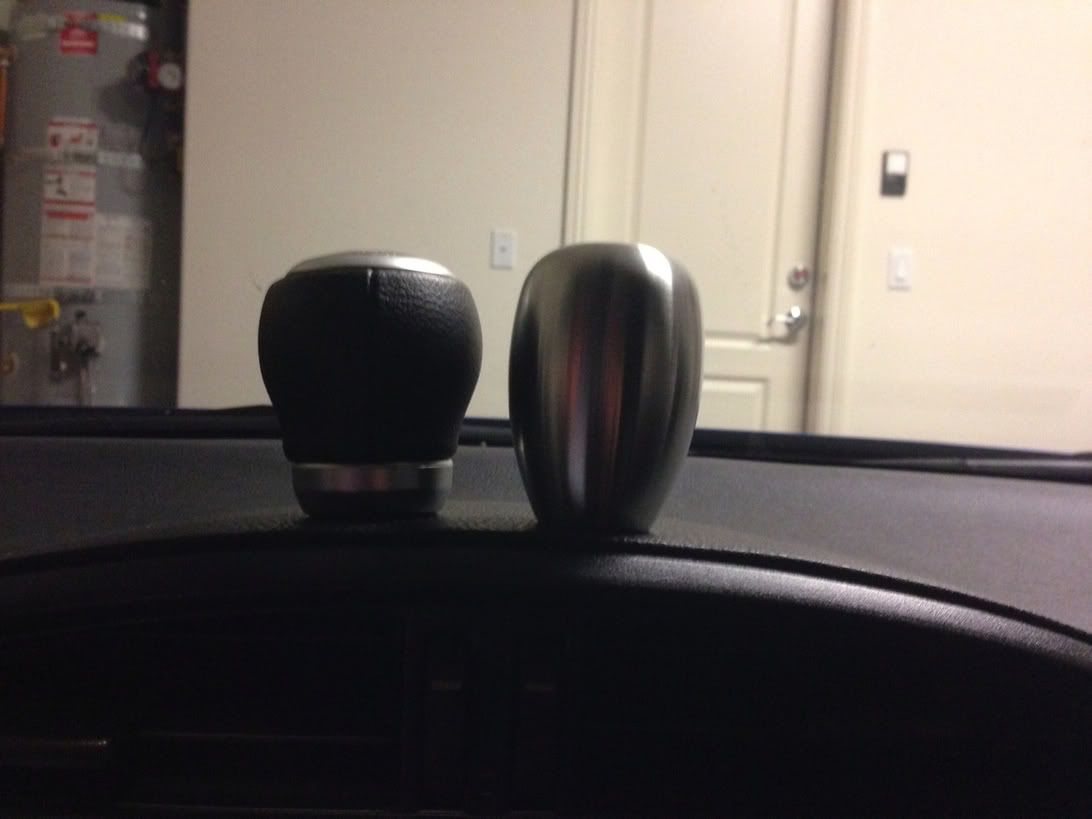

Ok time for some interior dress-up... Ordered a stainless steel Anvil 2 knob from Moddiction. Mod cost: about $80 for the engraved version.
As you can see its a little thinner and a little taller than the stock knob. However it's countersunk deeper than the stock knob so it sits lower on the shifter. It's also about double the weight of the stock one.
When screwed all the way down the knob is a little too close to the reverse lockout ring for it to function properly, and the engraved shift pattern isn't oriented properly (on mine it was off by 90*). It also spun freely there was nothing to hold it rotationally. So I did what they suggested, applied some light duty thread locker and left it a few turns higher to clear the lockout and align the pattern. I installed it tonight and will let it set overnight before driving it, can't wait to try it!
EDIT: Drove with the new knob to work today, sat in some traffic for a while so really got to do some shifting ... it feels really good! Throws feel slightly shorter, and the shift feel is more solid. It's subtle but noticeable. Looks like the thread locker is working fine, it sits on as tightly as the stock knob did, no issues with the knob moving or spinning from usage.

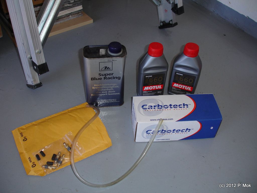

I've signed up for a track day at Thunderhill next weekend, so I decided to spend some of my mod money to make the car track-worthy. Based on the Motor Trend "Best Driver's Car 2012" comparo and other members' experiences, I decided I needed to upgrade the brake pads and fluid. It's not sexy like new rims or coilovers, but the last thing I want at the track is to boil my brakes and have my pads worn down to nothing and be stranded out there. So I bought a set of Carbotech XP8 race pads for the front brakes and some Motul 660 Racing Brake Fluid. I also grabbed a set of speedbleeders from Amazon to make it easier to do brake flushes/bleeds. I installed these items today and did a DIY write up on them, you can read that article here: http://www.ft86club.com/forums/showthread.php?t=24614
Mod cost: Front brake pads set $186, 1L of brake fluid about $56.

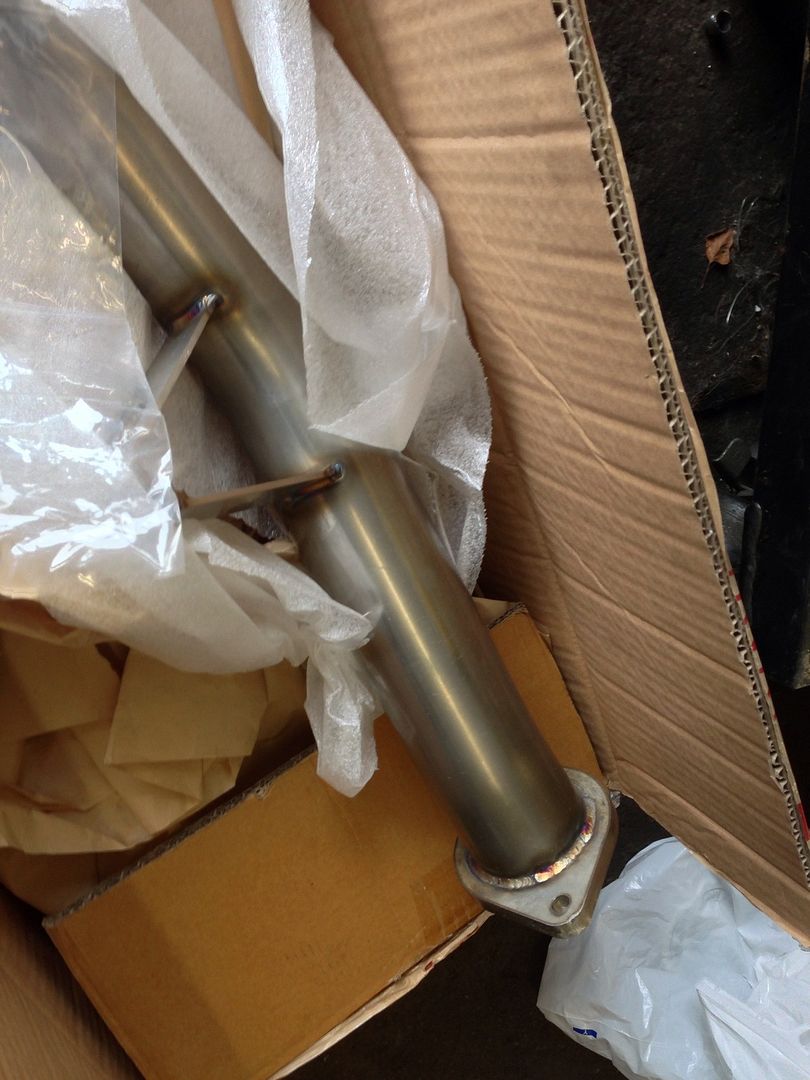

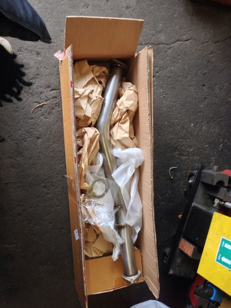

Took Stitch over to a friend's garage yesterday and we installed the camber bolts I picked up from the local dealership parts dept. I maxed out the negative camber (probably less than 1*) while my friend tightened the bolts. Mod cost: $14 (those are some pricey $7 bolts!)
We also tried to install the Berk catless front pipe but after taking off the underbody panels and starting to remove the stock pipe, we ran into a stubborn nut/bolt on the overpipe end. Looks like the nut got crossthreaded on the stud. So we had to throw in the towel and leave it to the pros. I took it in to a muffler shop today, and they had to use a torch to cut off the old nut and rethread the stud, then the Berk FP went on! Mod cost: $180 + $120 install
First impressions: drove home after the install and I do feel like there is a little more power in the low-mid range RPMs. Sound is not dramatically changed to my surprise, I thought removing the secondary cat and resonator would make the sound louder but it seems to be the same level, just a little difference in character. Keep in mind I still have the stock muffler behind that FP so for now it seems pretty ideal to me: reduce weight and flow restrictions, make more power, and remain stock OEM quiet. I'm sure if I change the mid pipe and muffler sections the sound will be much more aggressive but I'm not sure I want to attract that much attention yet.
