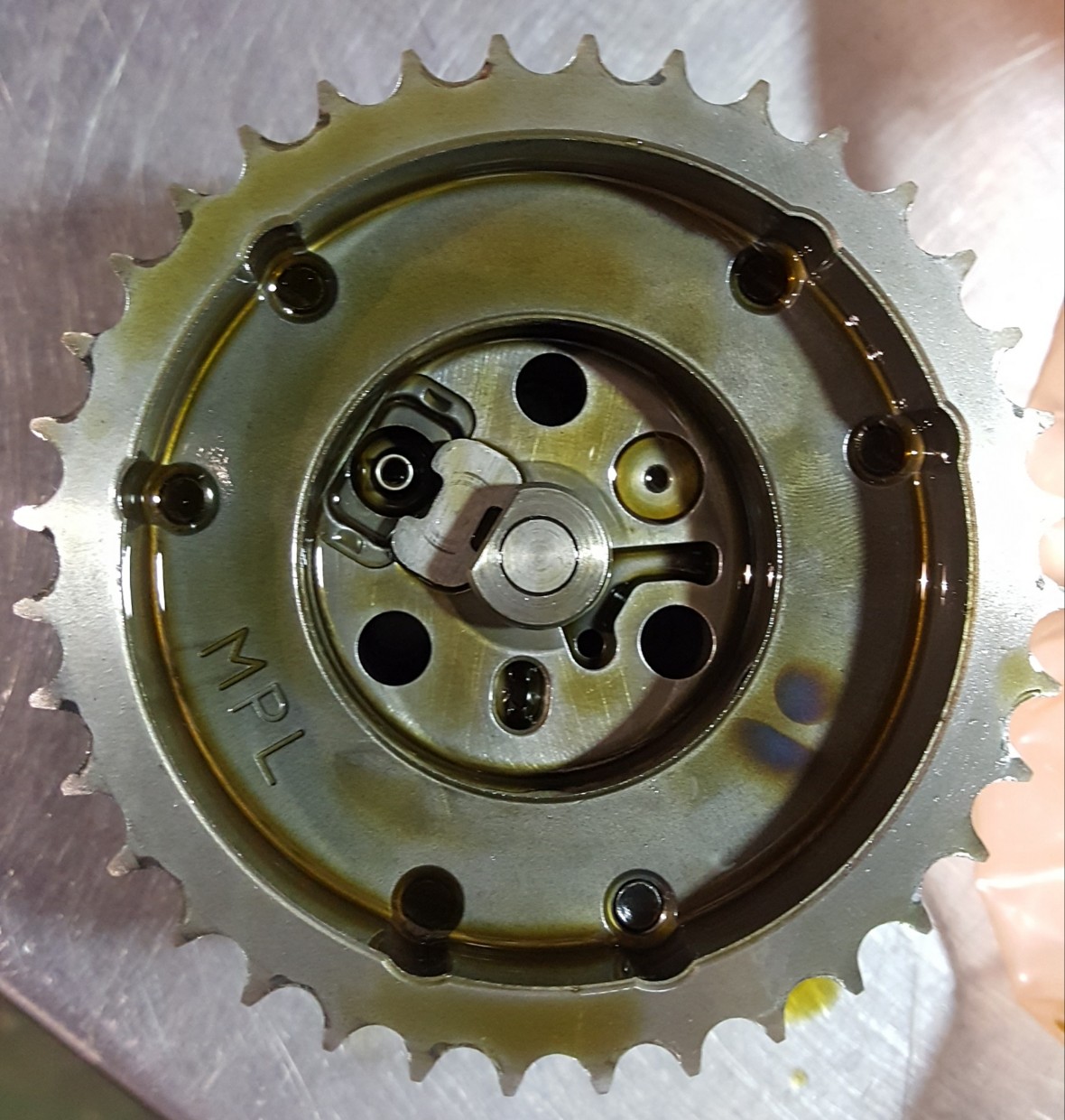

I forgot to mention this. Both intake cam gears were fixed before AVCS is working again.
Even with those small covers detached no DTC came in. It is most curious part indeed.
One gear was replaced with new one, another was only hammered on the both sides of the cover.
Those covers are only there to hold the parts in place until the assembly is mounted to the camshaft. People have incorrectly made a big deal about them popping off.
I would do the same thing, just peen the plate back in place.
