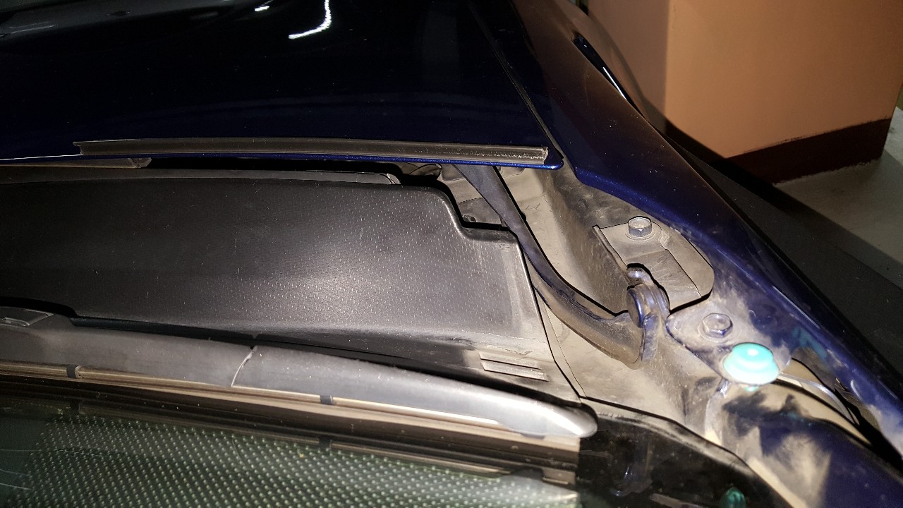

Originally Posted by makinen View Post
Under hood pressure should be counted for the venting. Pressure difference really makes air move.
I did an experiment for the vent at the cowl area on 2016. With the help of a Gurney flap, at least it blows out some air. I guess a blocking vertical barrier that divides low pressure zone and high pressure zone could help more.
I know it cannot blow out as much air that hood vent can. But could be better than nothing.
Or do make your own like this, @gtengr .
Looks functional for venting, but not the route I want to take.

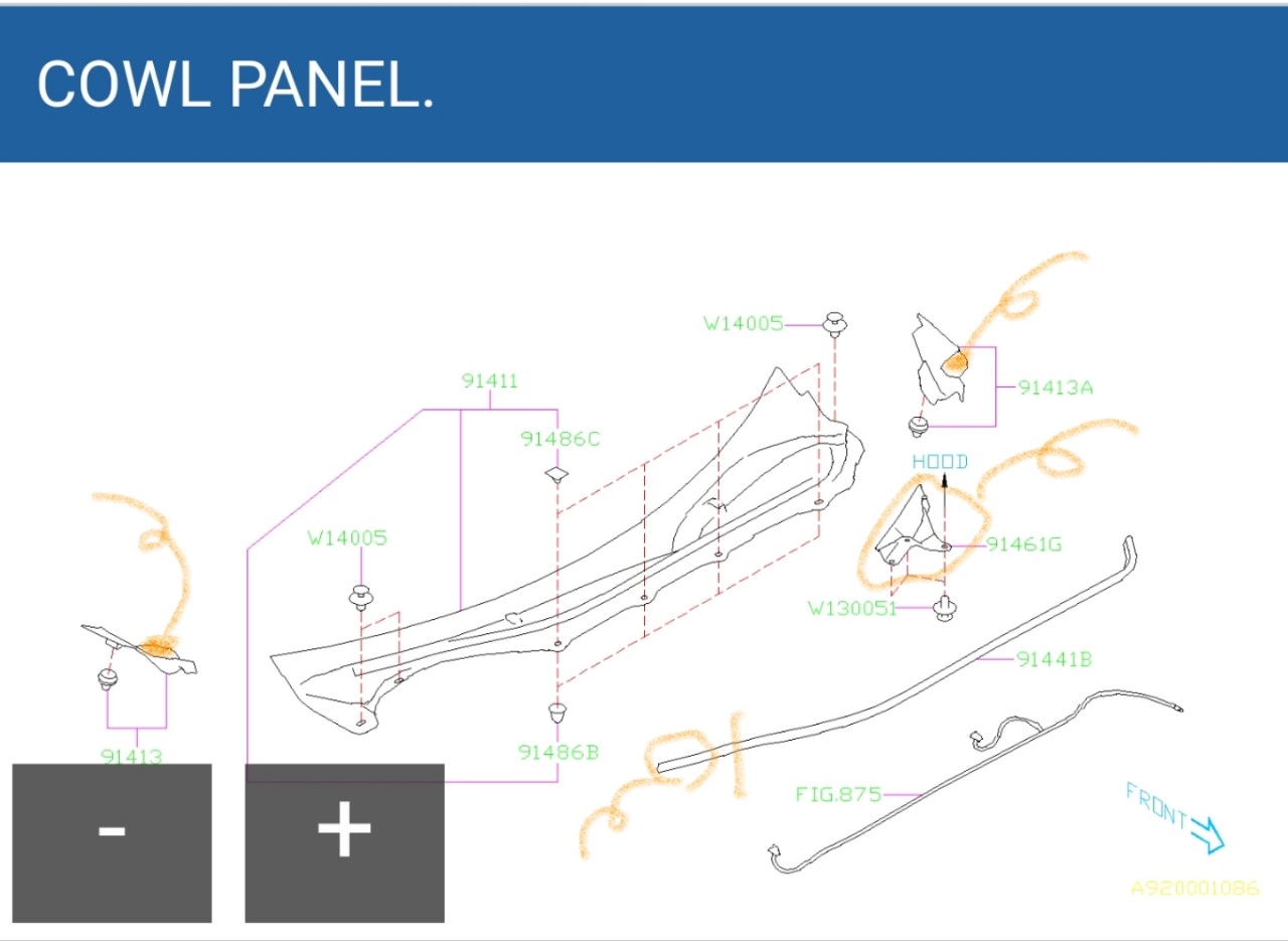

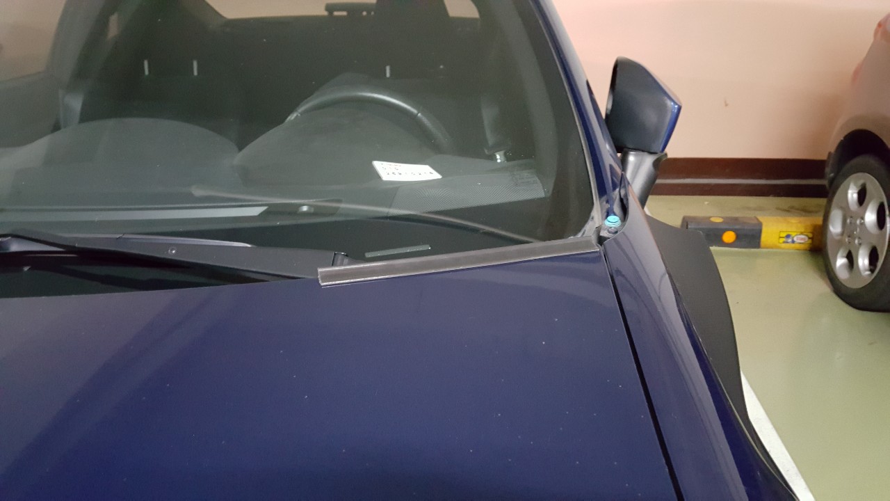

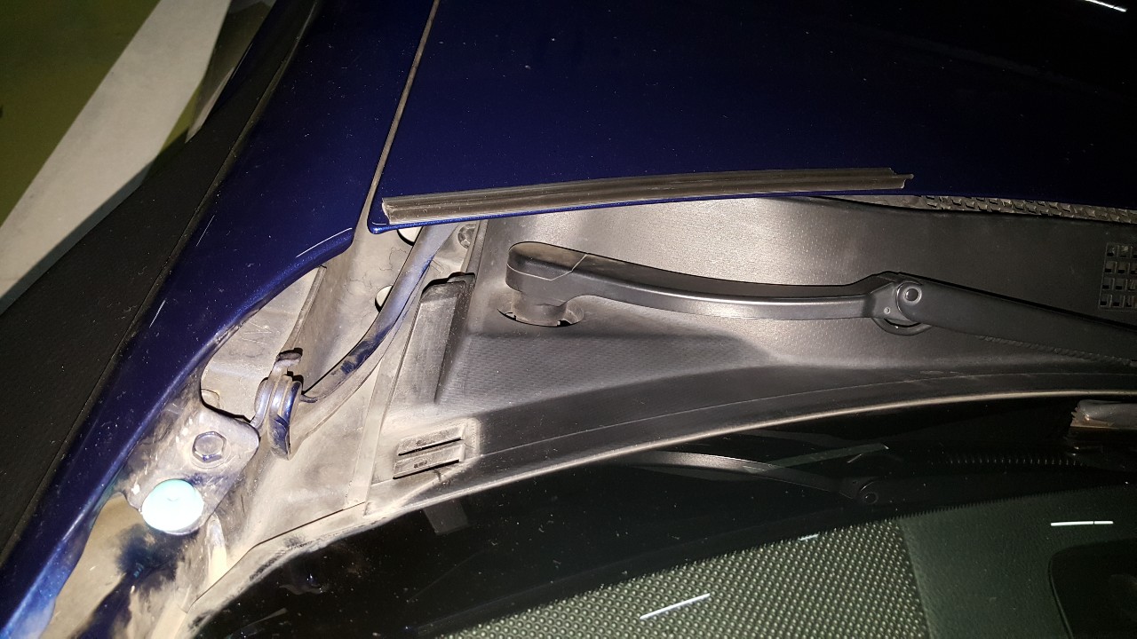

Originally Posted by gtengr View Post
Very nice! Did you just remove that plastic end piece and replace it with a grill? Any further cutting involved?
Just removed parts.
In the below pictures, I removed both parts at the ends of cowl area. But what I am actually using are only rubber parts removed from them. Those rubber parts which I colored in orange in the above diagram are for the fully opened posion of the hood.
Just removed parts.
Attachment 162124
Cool. I think I'll drill out those plastic pieces and leave some of the material there to cover up the fender bolt and some of the hinge. I'm going to wait until I get the Edelbrock on (waiting for the 2017 kits) before doing anything so that I can check it with datalogging.
