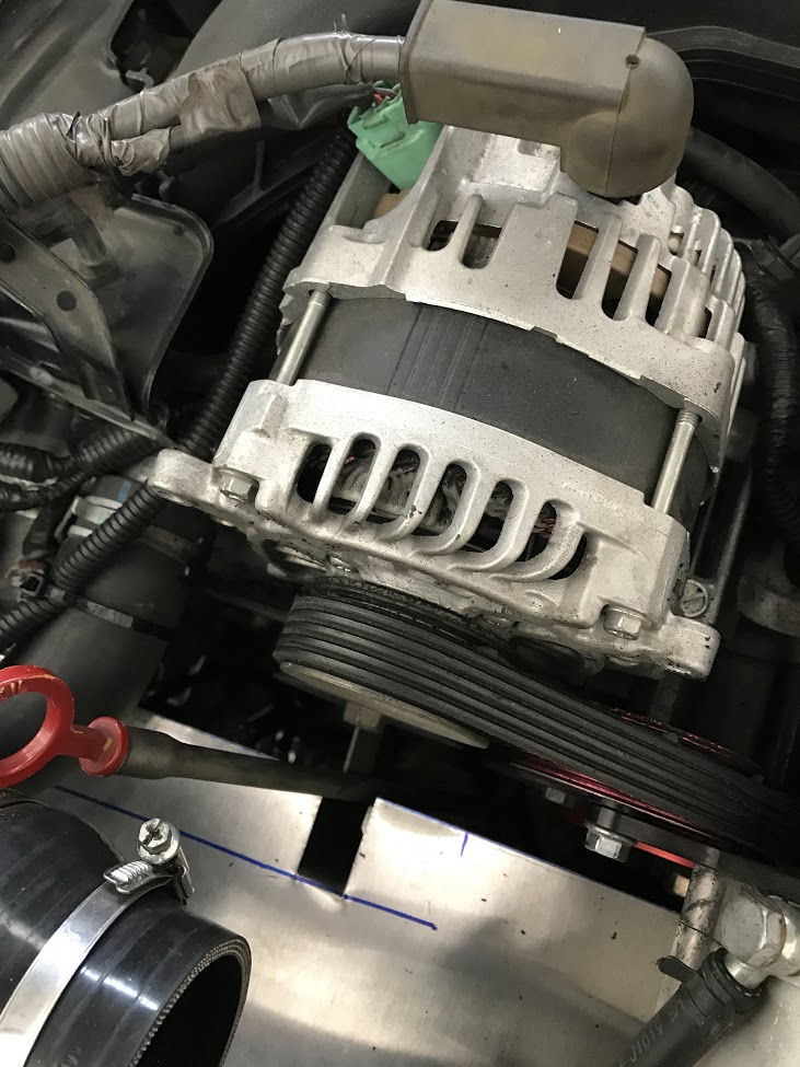

Ate my first belt this morning, happened about the same time I saw 10 psi haha. looks like the blower might be sitting to far forward just a hair and caused the belt to rub on the back and then fail....thoughts?
Attachment 183756
Put the all of the OEM pulleys back on.
Also you have the wrong idler on the alternator.

Are lightweight crank pulleys no good with it? I’ve ran this Perrin one for like 7 years, I don’t even have the original anymore. And the idler pulley was the one the previous owner gave me. It’s exactly the same dimensions as the other one you are referring to.
Nope, I had a similar issue. My belt was shifting, had to buy stock pulleys except for the crank since I have a fluid dampr. Go back to stock components and it should fix it.
