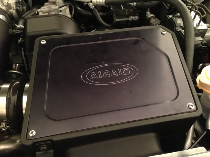

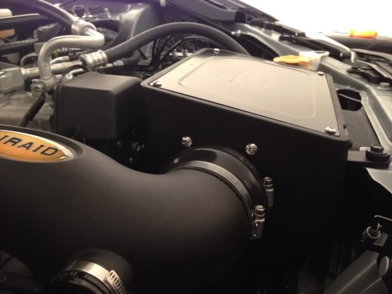

ok, now im getting a bit annoyed. When i installed this i tightened the hell out of ALL of the screws. And it seems like every time i pop the hood to check the oil i find somthing missing. Wether its the screws for the heat shield, or velocity stack. Lucky they didnt end up in one of my tires. Its gotten to the point that i went to home depot and got all stainless steel phillps screws to replace the hex ones and havent had a problem since.
Yeah I never used the stock screws from day one. Installed stainless screws with matching locking washers. Never had an issue, done right the first time! Airaid should have had some forsight on that one, but it's a simple fix
We're sorry you're continuing to have issues with the lid screws backing out. Did you try Loctite as we have suggested? I'm not sure what difference it would make going from hex screws to phillips head screws, but if that worked for you I guess it's all that matters. We have considered including star washers with the lid screws, but some have concerns with the star washers (or similar lock washers) scratching up the anodizing on the lid, hence why we've been recommending blue Loctite.

I live right off the ocean so any un protected metal tends to rust rather quickly. ill have to try and find a stainless flat washer to put under some star washers to prevent them from scratching the cover.
