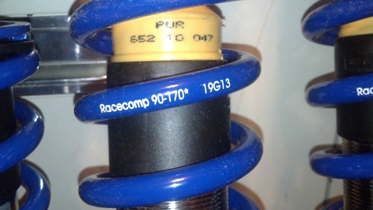

RCE T0's
mfbmike is offline   Reply With Quote

Originally Posted by mfbmike View Post
RCE T0's
HAWT ! No like literally because you're in Florida !
Myles
Old 12-14-2013, 03:01 PM   #459
mfbmike
Drives: 2013 FRS, 2008 R32
Location: Miami, FL
Posts: 1,201
Thanks: 715
Thanked 593 Times in 383 Posts
Myles
This is my winter mode setup.

mfbmike
Location: Miami, FL
Posts: 1,201
Thanks: 715
RCE T0's
