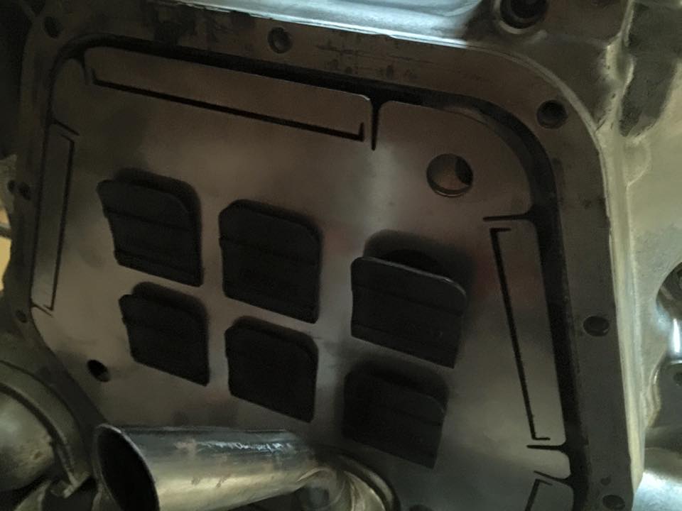

I had the Moroso baffle installed for a little while. I found at anything above about 6.5k rpms I got oil pressure drop/surge. Presumably because oil wasn't getting back to the pickup fast enough.
They are apparently re-designing it.
A proper trap door design like this looks like it would work better and the Cosworth imprezza baffles look similar.
ajc209 is offline   Reply With Quote

Considering we have 5qts of oil in that little pan I do not think there is a point to baffle below the edge of the pan, I will opt for a much simpler setup

Baffle plate done to control that oil from sloshing back into the heads

Test fit looks good
