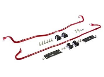

I just picked up a rear sway bar to try on my street class auto-xer, and am a bit confused by the bridge plate.
Is there supposed to be a cutout in the chassis side mount for the bridge plate to fit in? I can't find one on my car. The bridge plate doesn't seem to sit flush to anything.
I've currently installed the bar without it... although I noticed that the retaining collars can't sit flush to the bushing because there isn't adequate clearance to chassis mount.
The rear mount on the subframe should have a "valley" that the booby on the bridge plate takes up. What year is your car? Do you have any pictures of the mount?

Replacing a TRD rear sway bar, I realized I had the TRD reinforcement plate installed. If TRD thought the plate was needed for their bar, it's surely a good idea for the Hotchkis, so I just left it on and put the Hotchkis bridge plate back in the box.
