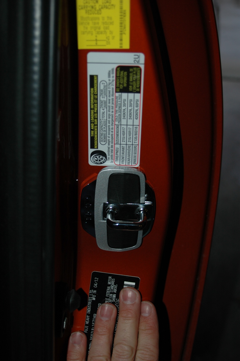

Installed the TRD Door Stabilizer kit today. Ordered it from Carson Toyota in CA for $190 or so and shipping was free as it was included with the TRD spoiler I ordered at same time.
The instructions are all in Japanese of course but the few diagrams included gave good hints as to how it would be installed. This photo is one side not yet installed.
Attachment 27582
Seems to be fairly straight forward. The black part in upper left is heavy duty plastic. The new screws are “star” screws so took a run to Harbor Freight to buy the bits for it. I also needed to pick up a screw driver socket set as I didn’t have one and it was necessary. Not bad for $20 total but then again it’s harbor freight so I get what I pay for. Tools I had to buy from Harbor Freight:
Attachment 27584

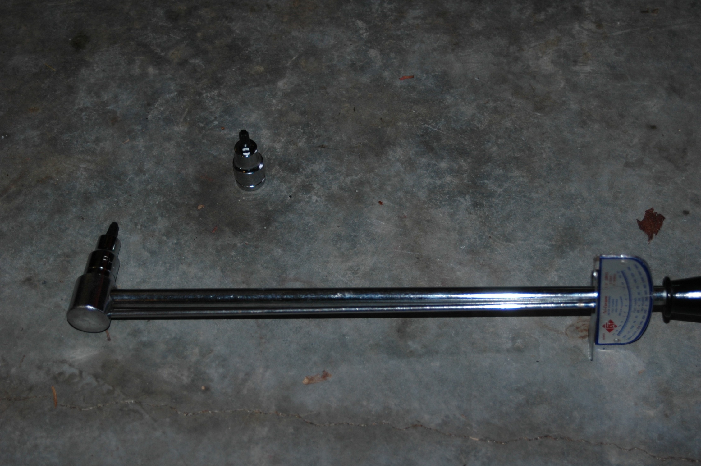

The hardest part of this whole project is getting those damn screws loosened. I thought a breaker bar with a Philips head would do the trick:
Attachment 27585
(As n2oinferno points out, you shouldn't use a torque wrench as a breaker bar but this is a very old and abused one so it's not doing it any more harm. You should use a real breaker bar if one is available)

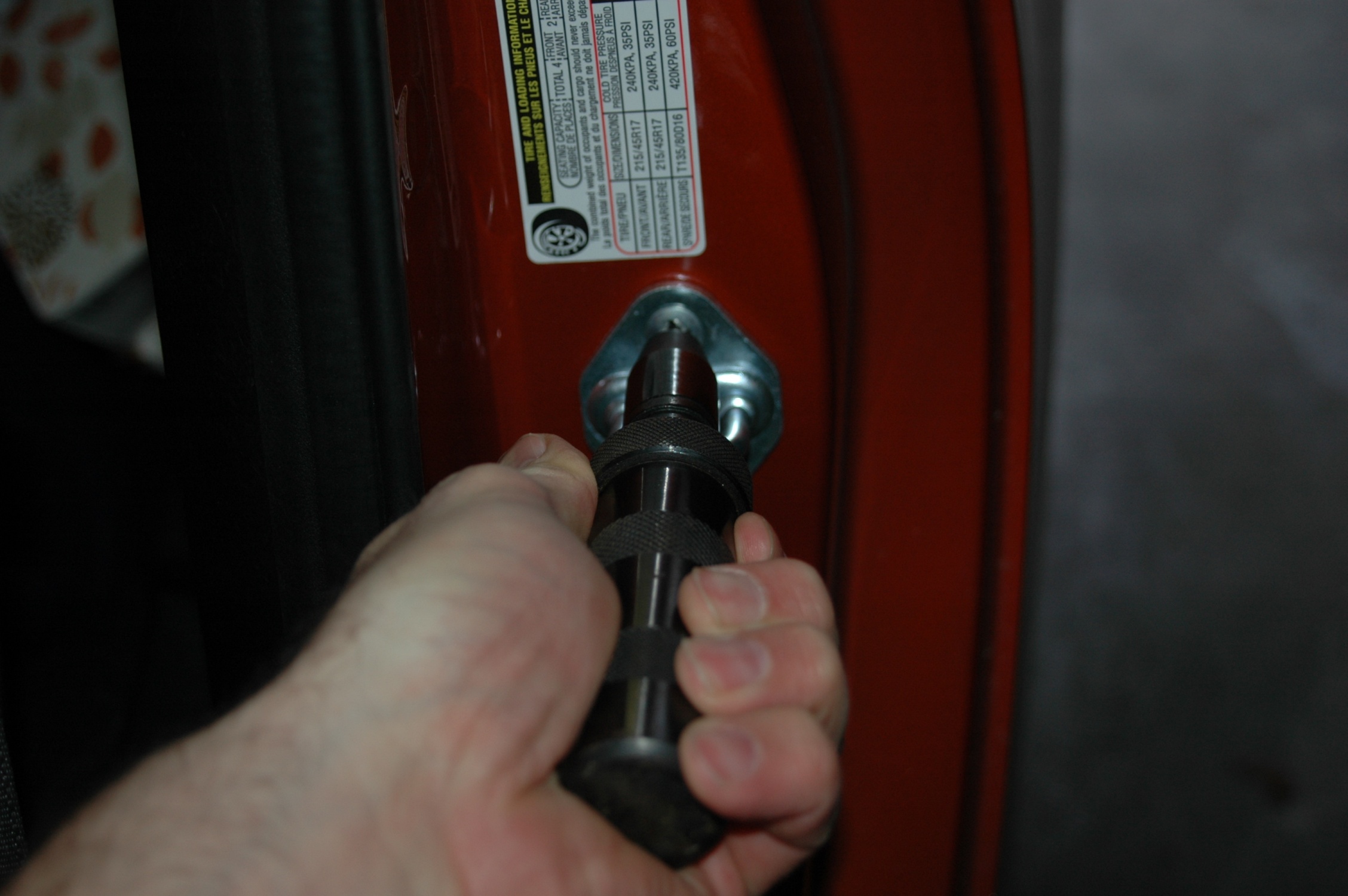

But the breaker bar just started to strip the screws despite how hard I pushed. So I resorted to using an impact driver and hammer just to loosen them a bit.
Attachment 27587
Hold it differently from picture or you’ll break your wrist with the hammer. After getting the old one off, it’s then just a matter of holding the “spring” section back and screwing in the new plate with the star screws:

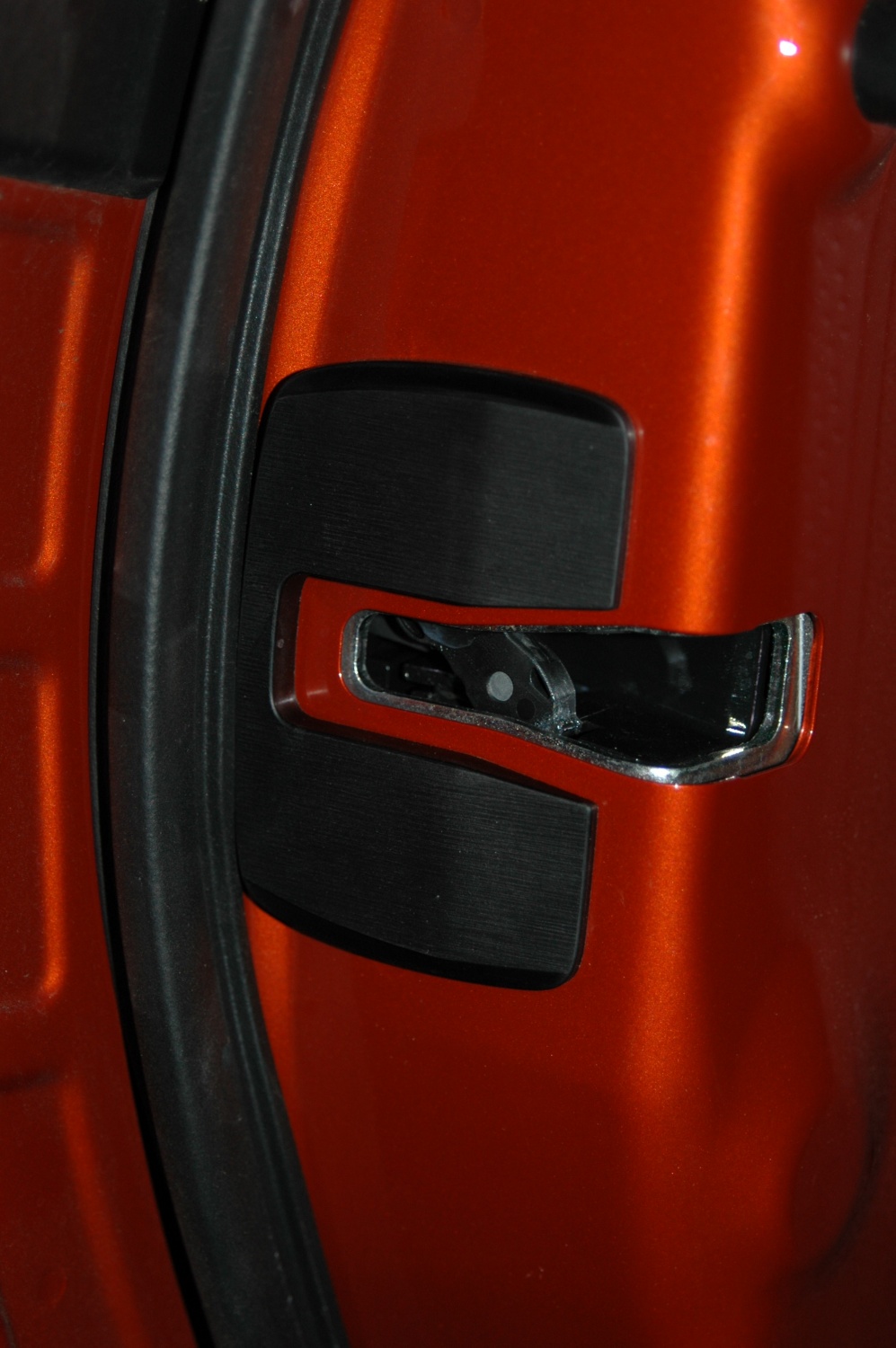

Push it into the bracket at the point above and then just gently push it to the outside to lock it in place. This is what is looks like complete:
Attachment 27592
I had no issues with fit or function, it did not affect the door alignment.
