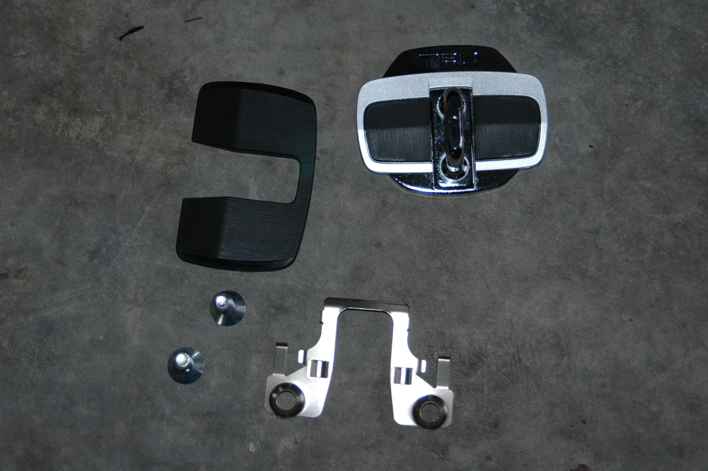

The instructions are all in Japanese of course but the few diagrams included gave good hints as to how it would be installed. This photo is one side not yet installed.
Attachment 27582

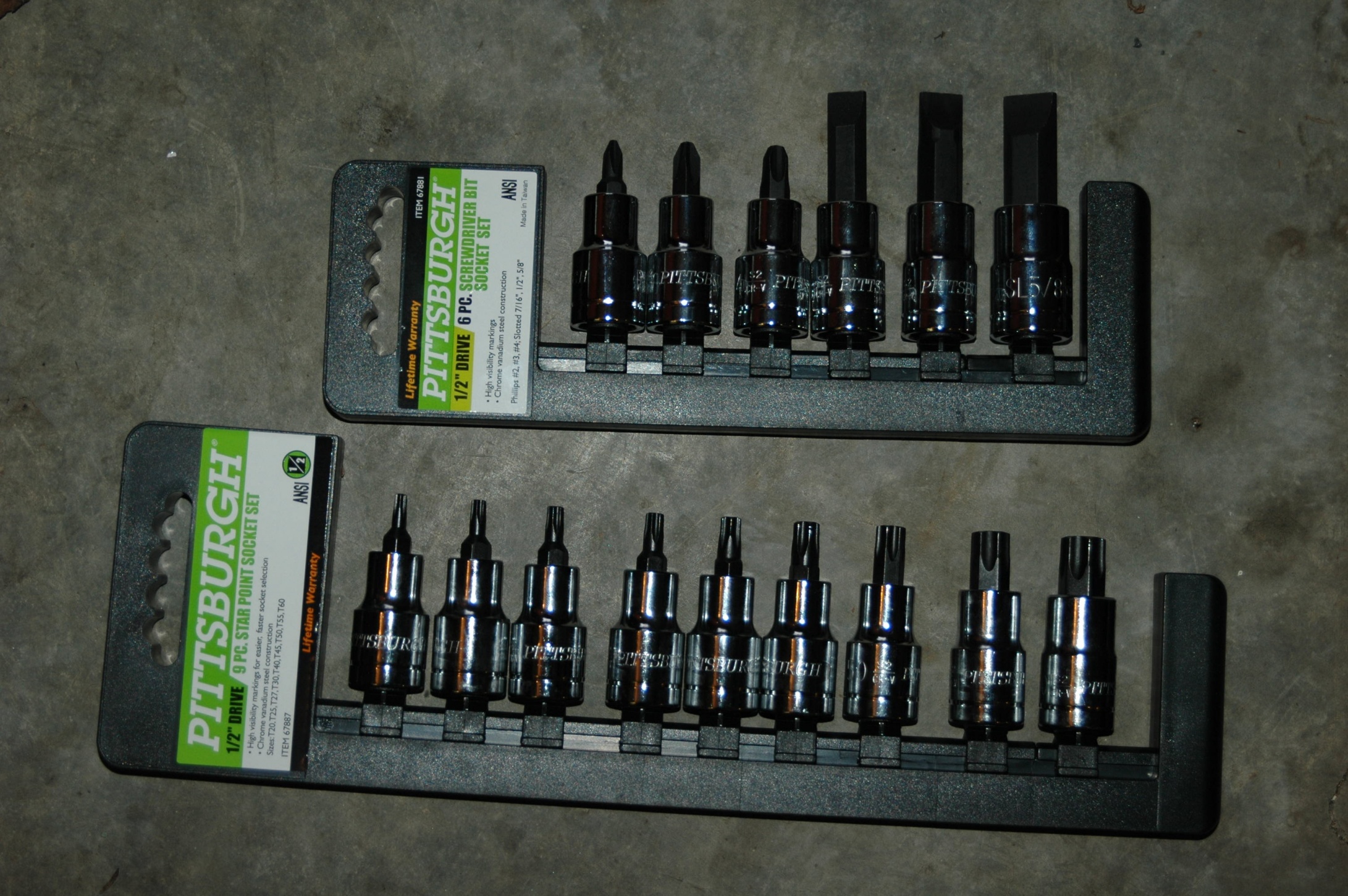

Seems to be fairly straight forward. The black part in upper left is heavy duty plastic. The new screws are “star” screws so took a run to Harbor Freight to buy the bits for it. I also needed to pick up a screw driver socket set as I didn’t have one and it was necessary. Not bad for $20 total but then again it’s harbor freight so I get what I pay for. Tools I had to buy from Harbor Freight:

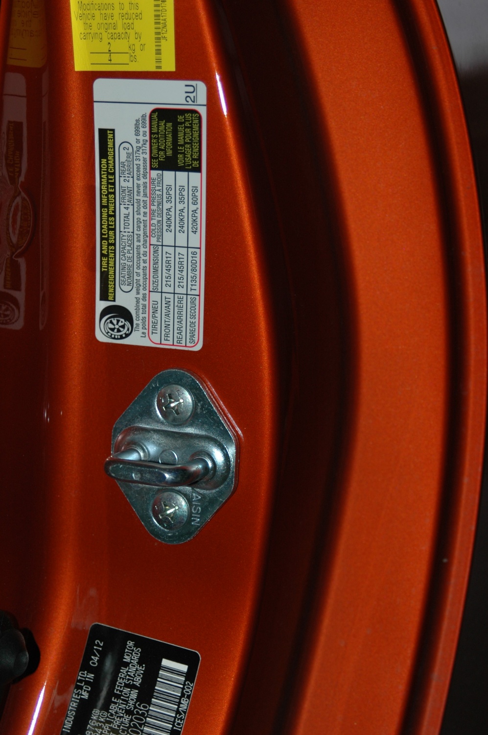

This of course is what it looks like before we start:

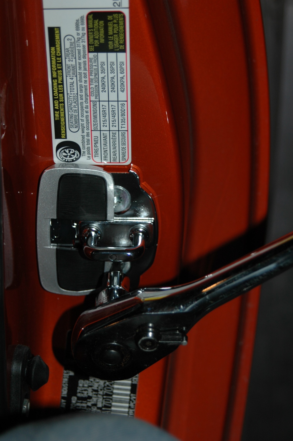

The hardest part of this whole project is getting those damn screws loosened. I thought a breaker bar with a Philips head would do the trick:
Attachment 27585
(As n2oinferno points out, you shouldn't use a torque wrench as a breaker bar but this is a very old and abused one so it's not doing it any more harm. You should use a real breaker bar if one is available)
But the breaker bar just started to strip the screws despite how hard I pushed. So I resorted to using an impact driver and hammer just to loosen them a bit.

Hold it differently from picture or you’ll break your wrist with the hammer. After getting the old one off, it’s then just a matter of holding the “spring” section back and screwing in the new plate with the star screws:
Attachment 27588
I found in the Japanese documentation that the torx screws should be tightened to 23 nm (~17 ft lbs). Thanks to Hanasuko for pointing out this fact.

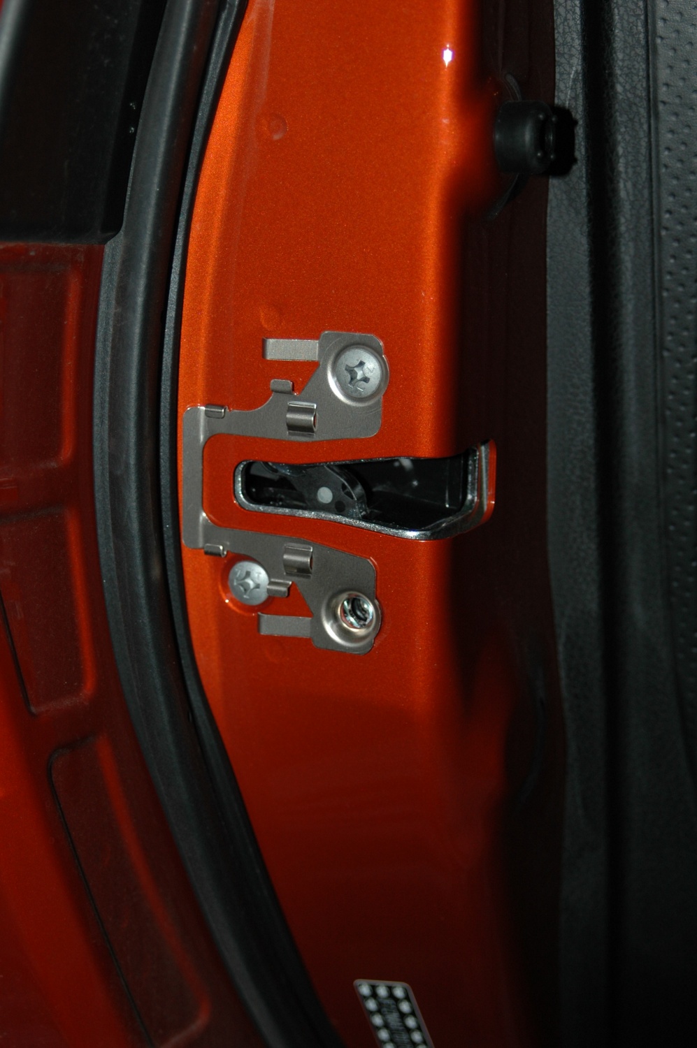

The screws on the actual door are trivial in comparison. It’s just a matter of loosening two screws and putting the metal bracket on:
Attachment 27590
Note that the lower screw isn't yet installed just to show how the bracket fits quite well into the screw hole. According to the doc, these screws should be tightened to 6.5 nm (~ 4 ft lbs). Then the plastic piece snaps in as so:

Two things I want to point out though. Using a torque wrench as a breaker bar (I assume this from the picture) will ruin the calibration on the torque wrench and make it useless for its intended purpose.
Secondly, the proper name for those "star" screws is torx, just for future reference. :)
