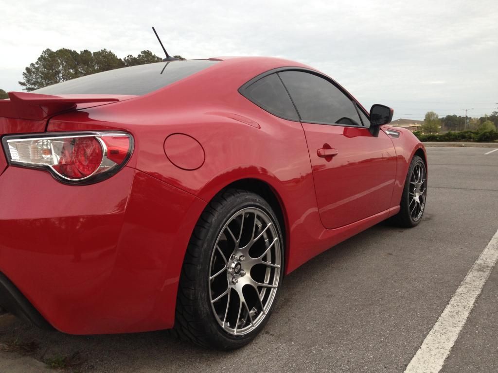

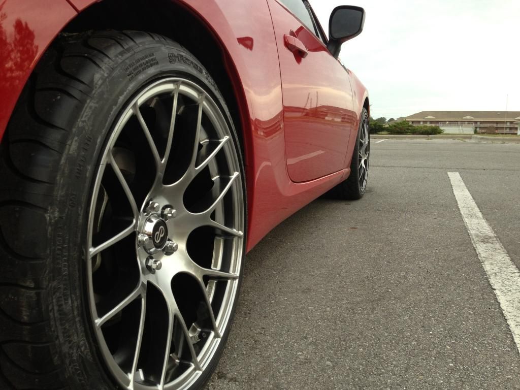

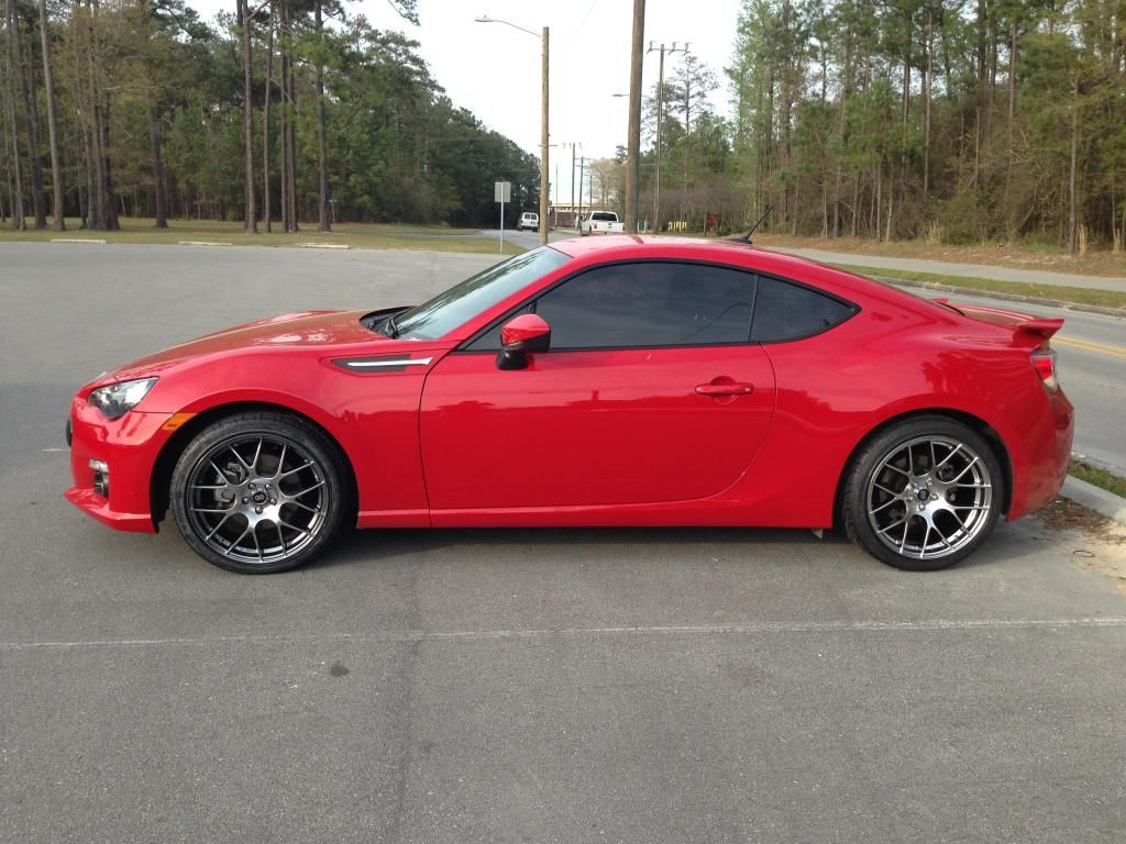

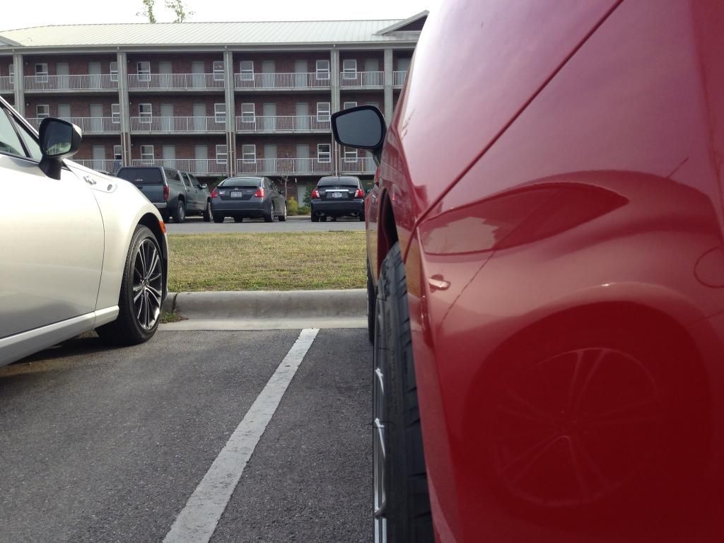

Nice!! Thanks for the photos! Looks really good. Performance-wise, did it feel heavier than the stock? Made much of a diff? Planning on getting the same set up. Thanks.
Originally Posted by mikepaul21 View Post
Thought you guys might like this, I just bought my Enkei Tuning Raijin's in hyper silver they're 18x8.5 45mm offset with a 235/35-18 up front with 18x9.5 45mm offset 255/35-18 in the rear. Stock suspension for now, I know the tires look like crap but I didn't put any shine on them yet these pictures were taken literally right after I put them on and I didn't think of shining them first.
Thought you guys might like this, I just bought my Enkei Tuning Raijin's in hyper silver they're 18x8.5 45mm offset with a 235/35-18 up front with 18x9.5 45mm offset 255/35-18 in the rear. Stock suspension for now...
Hi, I was planning on this exact setup. No lowering either, just the rims & tires. Do you have any regrets or rubbing issues? Thanks!

You won't have any issues with that setup, especially at stock ride height.
There's no fittment issues at all with this setup. I'd just suggest you so symetrical because before I got my coilovers I was getting some understeer which is annoying as hell.
