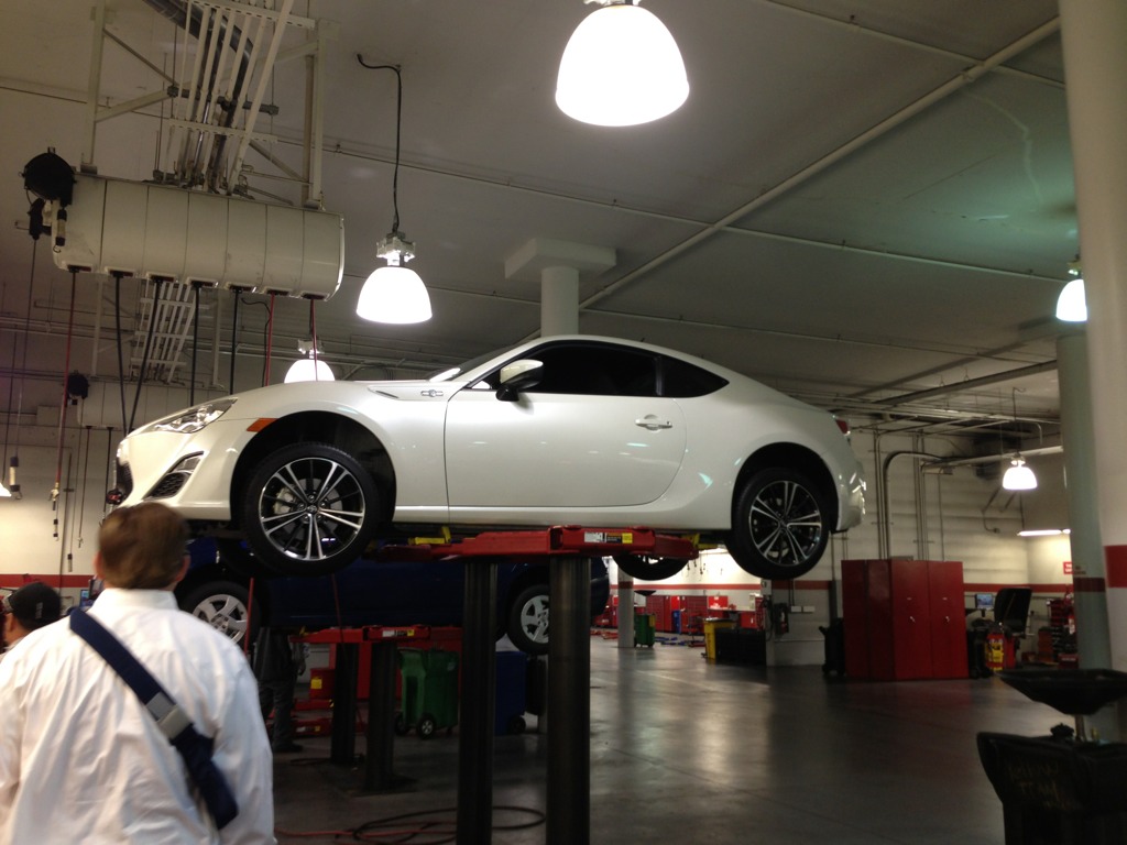

Well, problem found. Blown strut. Go figure, right? So, the car is staying at the dealer for a couple days. Car has 2400 miles on the clock. Toyota rep is coming down from irvine to document, strut is already on its way. They said i should have it back tomorrow or saturday at the latest.
Attachment 33571
How did they determine this? Leak?
No idea. I just took it to toyota and told them that the rear driver side strut was making some noise. I said that I doubt it was blown, but maybe the top nut loosened a little. I waited for about an hour or so and then the service guy came in and told me that he needed to keep the car and that the strut was blown.
The car is a DD and most of the roads I go on are REALLY smooth. Having had a super low car as my last DD, I still tend to avoid the rough roads. Odd, but at least it's under warranty
