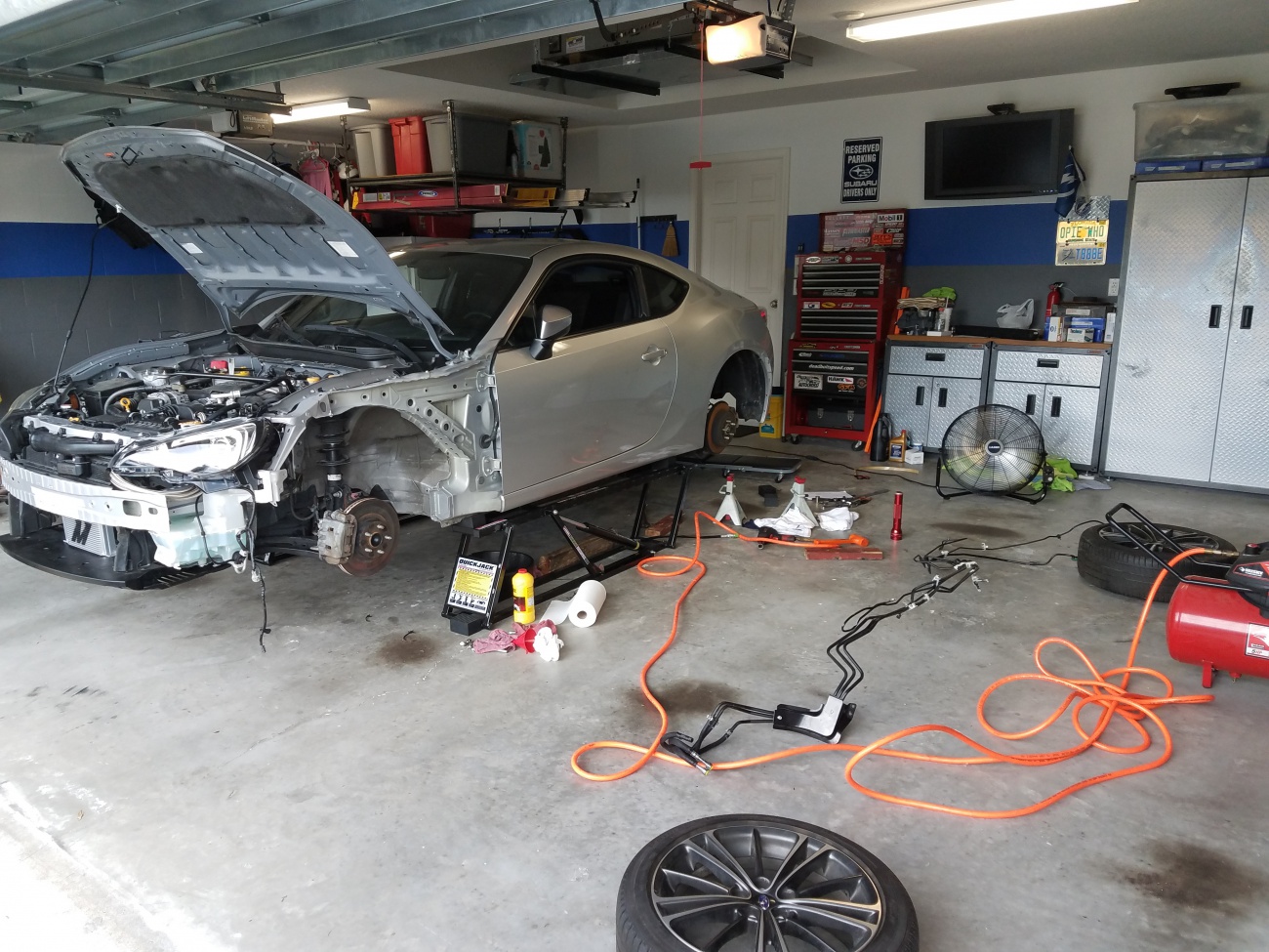

Busy Saturday...

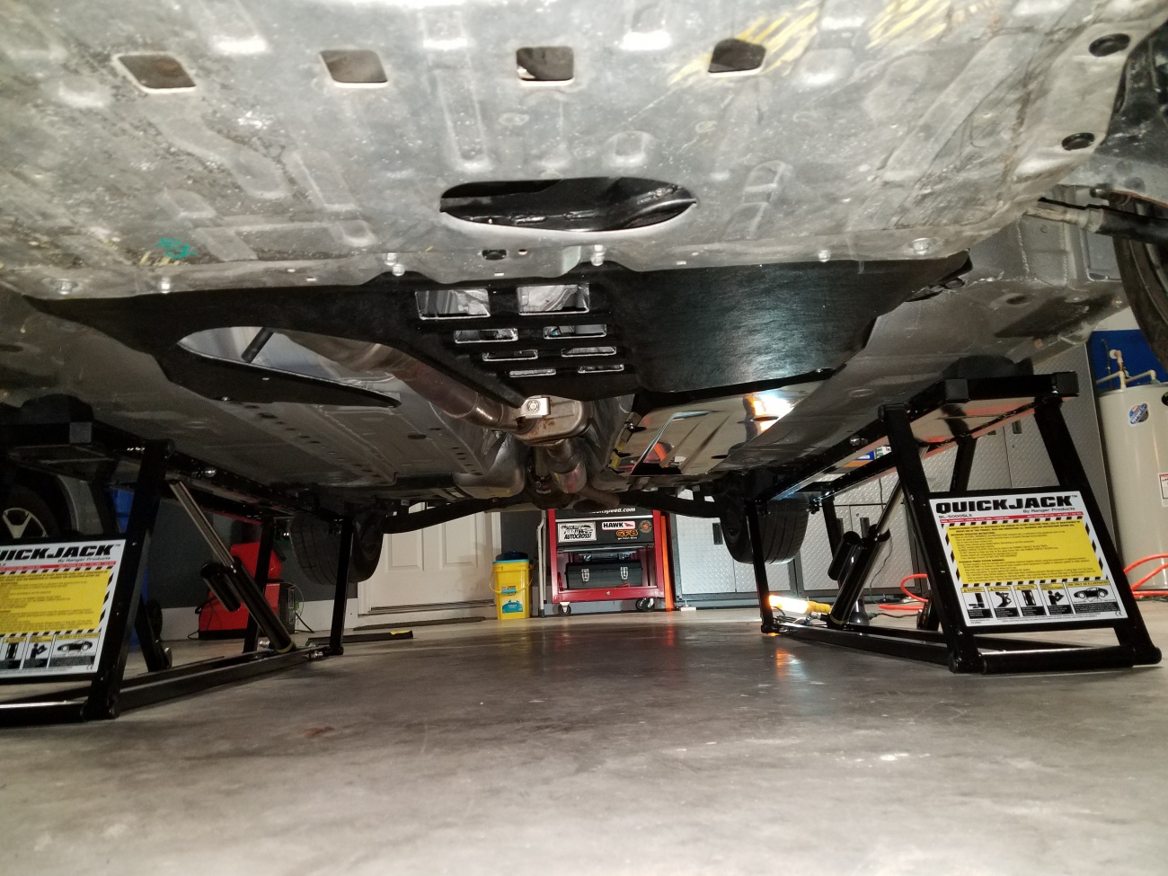

Removed the exhaust, driveshaft and fuel tank and lowered the rear subframe to replace the fuel/brake pipe assembly, what a job! But it's done and the car has brakes again!
Before:
After:
And:

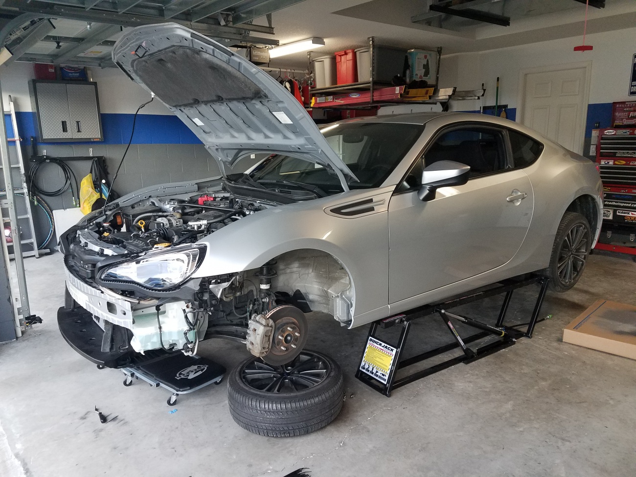

Got the last of the underbody repairs completed tonight!
Now I'm just waiting on a tie rod end and a rear lower control arm to come in to set it back on the ground for good! Got the TPMS issue sorted out, got two new keys programmed, cleared all the codes from all the systems, took the SRS control module out and sent it off to be reset, installed a new battery & wiper blades. If the fender and front bumper cover get painted by Weds or Thurs I should have it completed by Monday. Then I'll be submitting the paperwork to the state to get it inspected and the title issued!

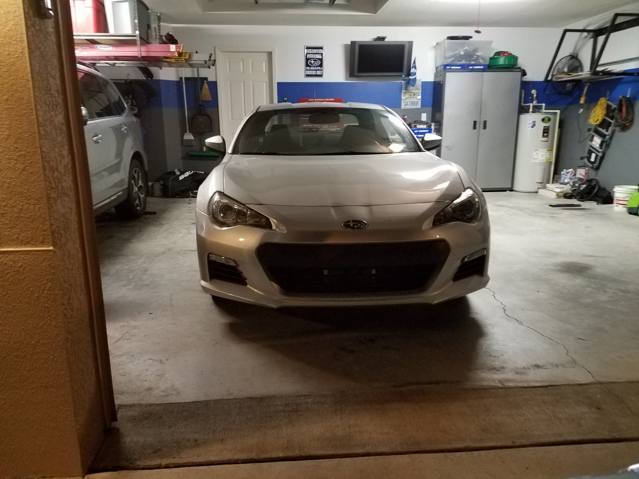

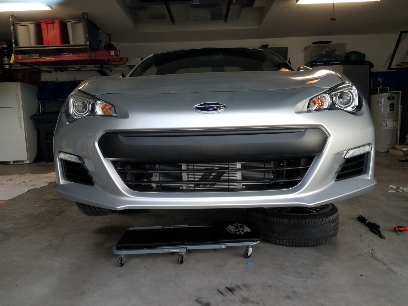

Getting so, so close! Installed the LH outer tie rod end last night, got the fender & bumper from the body shop today, installed them tonight!

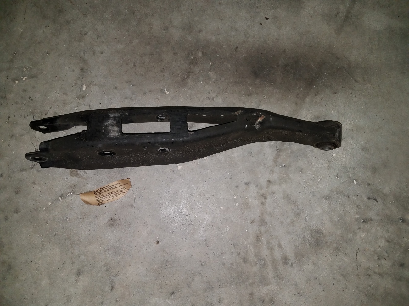

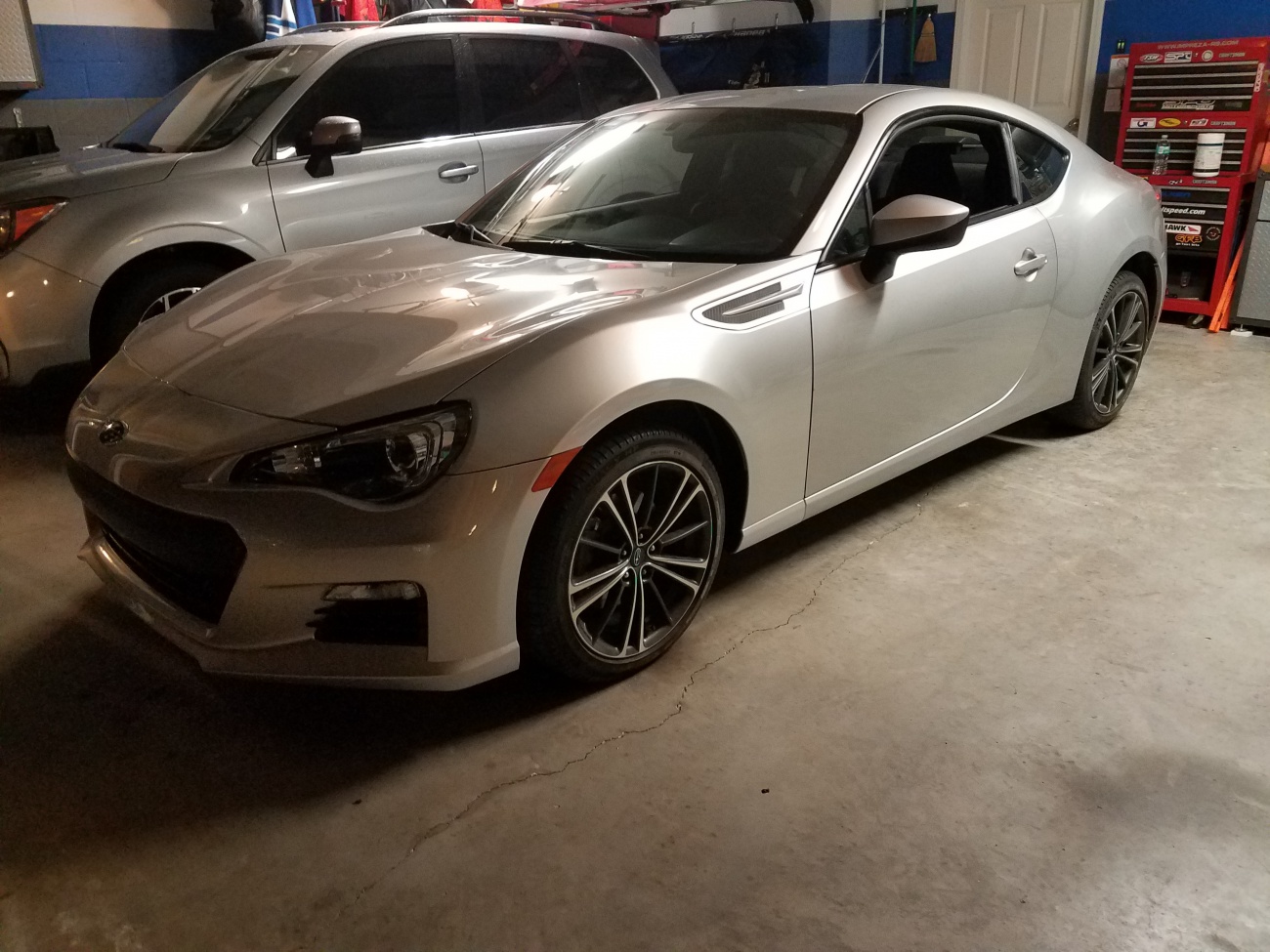

Replaced the left rear lower control arm...I hadn't noticed that it was bent until I pulled the fuel tank last weekend.

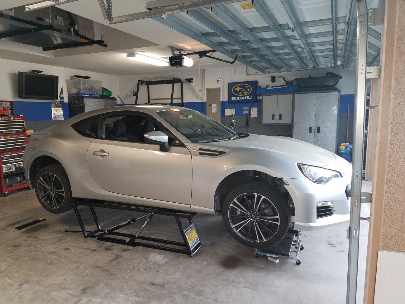

Got the fender liners installed and put her back on the ground!
