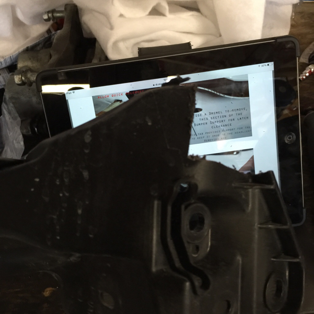

Sure. I started out taking pics but neglected it as the process went on.
They could of done a better job illustrating what needs to be cut. Essentially it's the upper corner closest to where the forward latch will be sitting.

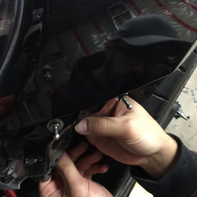

If you want to save yourself some headache, take your wheels off or have the car in the air so you can turn them out of the way

Other than that, all the pics you need are in the instructions

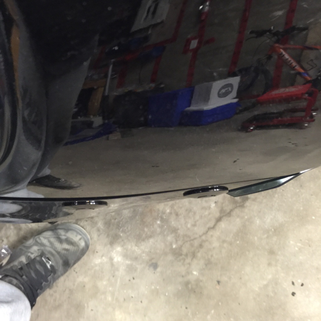

Attachment 109873
Attachment 109874
Attachment 109875
Attachment 109876
Looks good... in one of your pics the bumper is still out a bit... was that pic taken pre-adjustment?
projekt zeal86 build
It's the angle and lighting. I noticed that too and double checked to confirm that it's flush
