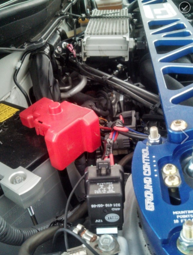

Added a blue rubber gasketed waterpoof relay to my oil cooler fan, thought I'd share the parts:
the diode before the relay lets me put a lil toggle switch in the cabin if I wanna run the fan non stop independent of what the rad fans are doing. great for track days.
this way I am not drawing power thru the factory wires.
Will update with under hood pics soon
HELLA H41410081 Weatherproof 20/40 Amp SPDT 280 Footprint Mini Relay with Bracket
HELLA H84708001 280 Weatherproof Relay Connector with 12" Leads
Blue Ox BX8864 Saturn Diode Block Pack - 6 Amp
havent figured out what where switch etc
