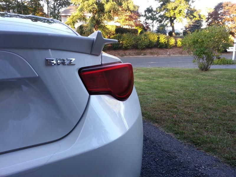

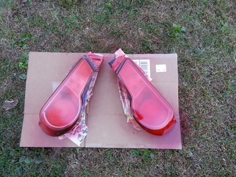

Mine came out good, I will be doing clear coat with SprayMax 2k next week. I used MetalCast for the red.
1. Ready for prep. 2000 grit paper, bucket of water, windex and paper towels. I only windexed prior to prep.
2. Both tail lights sanded evenly and then masked. This part is time consuming, just be patient. You will need to completely dry the light to see what parts haven't been sanded, sand missed parts, repeat.
3. First coat of red
4. After 3 light coats and 2 heavy coats, 30 mins in between.
5. Done and installed. Still have to do clear coat. The lighting is bad, they do not look this dark in person.
