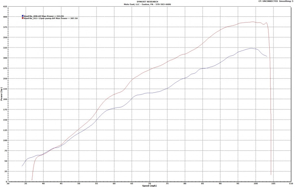

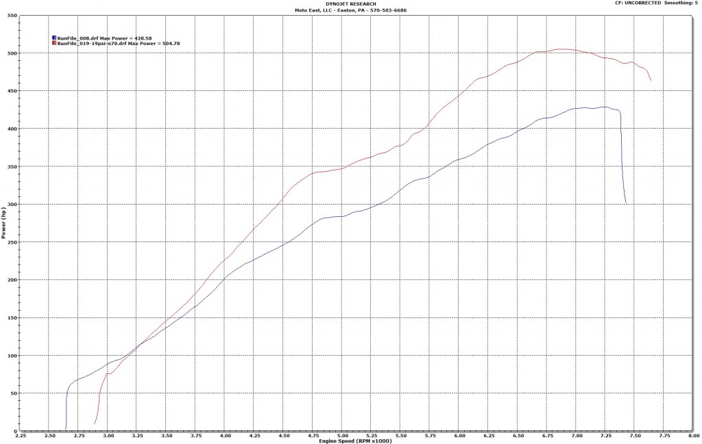

Originally Posted by SPCorBUST View Post
Looking like the San Andreas fault line on the top of my motor...
I'd like the next motor to be 12.5:1 CR, 7.5k redline (maybe slightly higher if it can be managed safely), C38, HBP, E85, I'm exploring what the motor needs to be safe under those conditions.
Ouch, that sucks. I wouldn't get too caught up about the 12.5:1 CR. After building several 10.5:1 and 9.5:1 and driving/tuning them after the fact, you'd be hard pressed to ever know that it was lower compression aside from the fact that there's much less knock at high boost. With a turbo/SC it is such a minor difference that unless it will be a strictly e85/meth car, then the low CR is not a deficiency. Just my opinion...oh wait, no, lets add some data
Hint, one of these is on pump gas, the other on e70. Both with the same exact car, same turbo, same everything other than built motor dropping 3 points of compression. This allows not only 5 psi more boost, but also allows more aggressive cam and ignition timings. AFR is the same. Those are turbo journal bearing results.
A roots/twin screw can benefit from the higher CR on 93 or alcohol. But on pump most blowers out there right now can be spun down enough to generate more hp/heat then the high compression knock ceiling. So still a good idea to drop a couple points.
EDIT for clarity, red lines are LOW compression. Blue lines are stock pistons.
How does changing CR affect emissions? Being in CA, CARB is a major concern and is one of the main factors for my build. It's the main reason I may not go for any head work like porting or oversized valves. I could get away with appearing CARB but I think that sniffer is another story.
