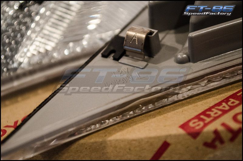

3. The side markers clips are probably slightly bent making, just look up a pic of the side marker tab A and just use a hair dryer to heat up the tab and then get pliers and slowly bend it back bit by bit. Make sure you keep it hot so you don't snap that dam thing. Takes some time (happened to me too )
Need it like this
