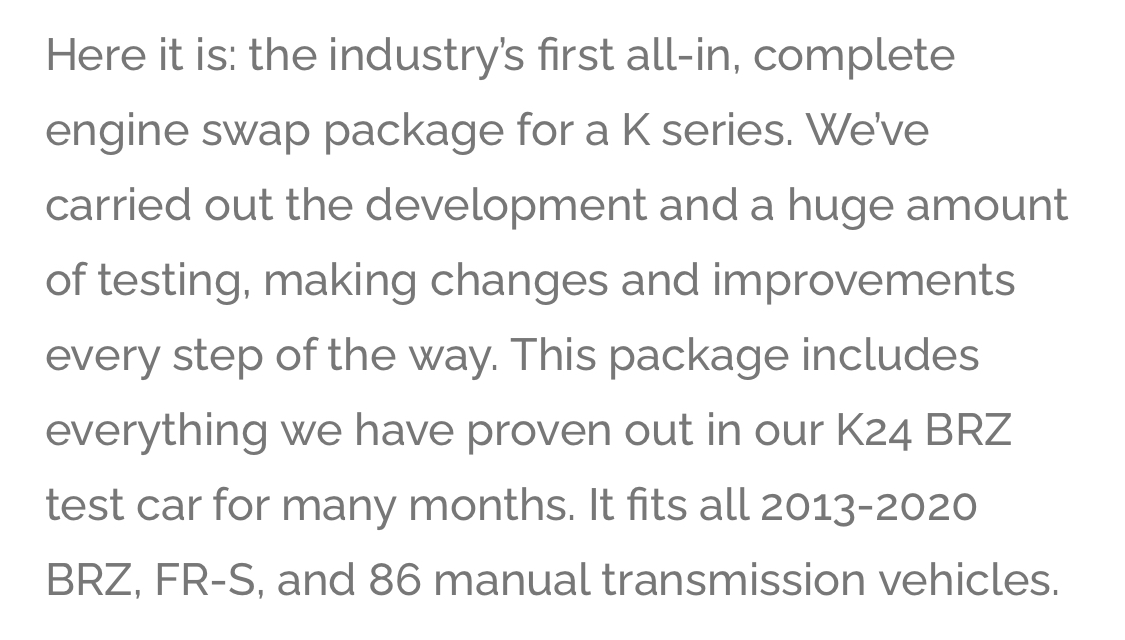

So WITHOUT the k24 engine, the complete kpower kit to get only the components needed to k swap our cars and still have AC is $11530.
For reference, that’s more than I paid for my 2013 FRS five or so years ago.
I get that the cost of everything is way up. But, wow, that is a lot.

^^ Most business owners don't understand volume pricing. They want to make back R&D within a certain time frame. Plus they are have all these other outside vendors actually make parts once they did the R&D thus raising cost.
Still though. I would buy. Get a chassis with a blown engine, throw this kit on with a built K24 and you kicking some Mustang a$$ at the first exit out of Cars&Coffee!

A supercharger kit is a supercharger, a cast manifold, a radiator, a pulley, an intake and some piping, and it is $5-6k. This is a cast manifold, a welded oil pan, an aluminum driveshaft, a billet trans adapter, a flywheel, billet fuel rail, ac kit, an engine wiring harness and sensors, a stand alone engine management system, etc. I could buy an entire old car with a supercharger on it for the price of a new supercharger kit, and that has always been the case way before the pandemic.
Engine swaps aren't cheap. They never were. You are looking at low volume, custom parts that are often made to high standards or would require tooling that is only affordable at high volume by manufactures.
With that said, the price isn't that bad for what you get, and you could build the kit how you want. That $11,530 price includes headers, an aluminum driveshaft, a lightweight flywheel, cold air intake and premium clutch kit. Price those items for a FA20 and you could be looking at $2k+, so now the true difference in price is $9500. Sell the FA20 for fair market value around $3500-4500 or $2500 for a fast sale, and now there is a difference of $5000-7000, and now we are in the price of a supercharger kit, except we are taking off a hundred pounds of weight. Now the price isn't looking so bad.
Yeah, the supercharger is capable of adding more power, but some may want a platform for less weight and more NA power. The K24 will probably outperform a supercharged 86 in CARB/base form, and it will be much more reliable doing it, and it will be cheaper and easier to service and replace. Again, this makes the money proposition more appealing. I'm not saying it is cheap; I'm just saying it isn't as bad as you imply.
This right here is what people need to see. Not "OMG 11k for a swap, I could buy a whole car for that". I could have bought several cars for the cost of my swap....

And actually the weight is more. Most supercharger kits add 50-60lbs, and this kit may drop around 140lbs, so 200lbs difference in weight.
Some of that difference could be made up on the supercharged car by adding light weight items, but that is extra money too, so again, the price doesn’t seem so bad.

Does anyone know if the current electronic package (wiring and ECU) works on a 17+ car? As well, does this swap retain factory traction control?

I think they are still confirming 17+ compatibility, but a quick email could confirm that. Luckily they respond in a respectable amount of time for any questions I have sent so far.
Factory traction control should be good to go regardless.

It works. It is only for manual transmission vehicles though.
