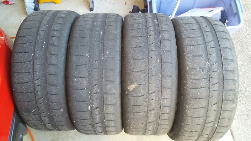

Since we are talking about tire wear. Here are my Rival S's after 156 runs on course asphalt (Packwood and PIR). They were flipped after 70. Not too bad.

How is grip at this point?
Seems pretty reasonable to me. I'm expecting to flip around 80 runs.

Wow, someone else is actually running the rival S? So little love for the tire compared to the 71R. Running 225 or 245? I'm on 225's and have been curious what others are running for pressures. I knew it didn't have a sidewall as stiff as the stones, but I've found mine to need pressures at or north of 35f/33r
