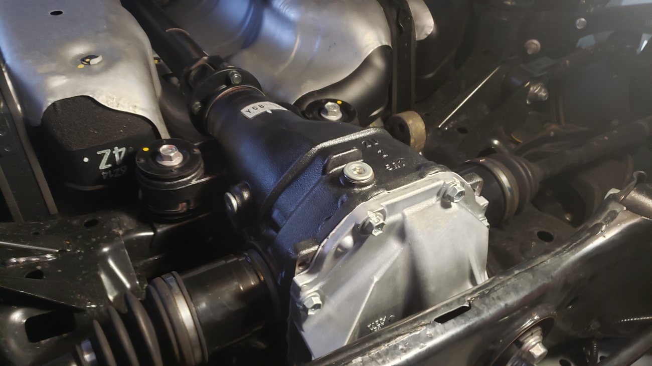

Originally Posted by Decep View Post
Yeah it is comical how quickly the car goes from 75-95 mph in 6th gear on a manual compared to stock. Took me a while to stop accidentally getting into impound lot territory.
Should be even better now that I just finished installing a 2018 MT 4.3 diff info my 17 AT (4.1). I love this car because stuff like this is available for a few hundred off Ebay and just bolts right in.
