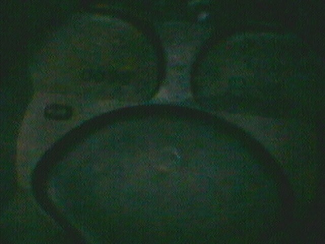

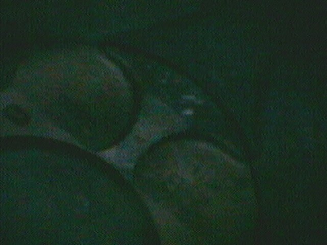

Originally Posted by peachch View Post
Not yet. I will keep you post.
Just got the word from Mike @PrimeMotoring
That cyl 1 is good
