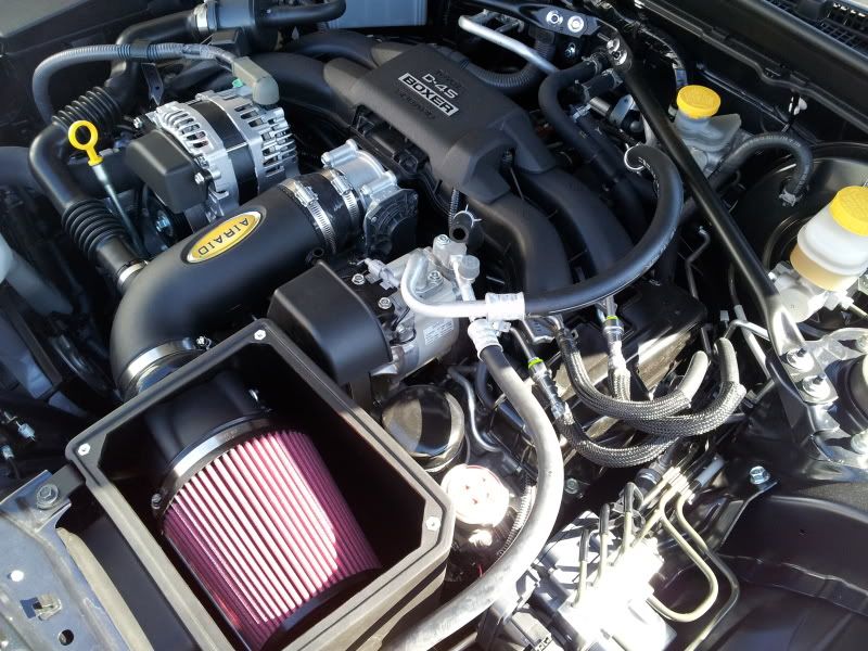

Got around to installing my Airaid intake yesterday after Airaid sent me the correct elbow by air overnight.
Pros: Looks great, sounds great, powerband feels a bit beefier. is amazing sounding at 6k and above!
Cons: Don't feel like it revs as fast as stock did at lower rpms but revs do pick up in the higher rpms.
I have no bogging issues at all tho. Tried the testing of letting the car settle at 5mph then flooring it and no problems with the engine building power up.
Overall my experience with Airaid as well as AJUSA have been phenomenal. Both were quick to answer my PMs, helpful whenever a issue came up and both were easy to deal with. Out of everything I have bought for my car with the vendors on here I would rank Airaid and AJUSA top 3 easily. I'm still waiting for parts I've order months ago from some so a vendor that lays out a pretty accurate time frame as well as communicates with the customers in a graceful and effective manner is truly a nice change.
Here a pic of my install and I will be posting up a pic of my car in a little bit once I throw on my spoiler!
That actually is part of the bogging issue. Mine started out by being slow to rev. Keep us updated as you put more miles on it and do the 5mph WOT test if you dont mind.
Hope you enjoy it. I just put my factory box back to see which one do better in town cause I felt the airaid box is not smooth in city driving. And there always lag in low rpm. Will do more driving tomorrow.
