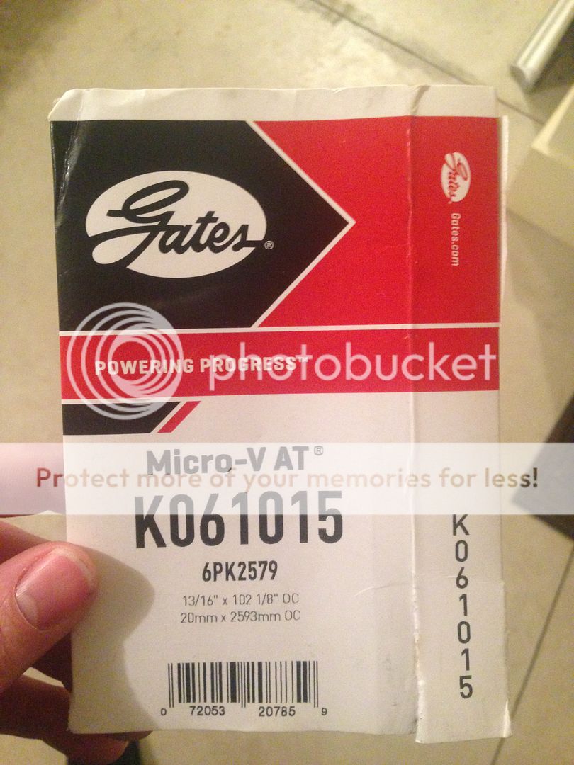

I had a Gates RB shred on a 70mm pulley. I am back on the stock 75mm pulley with the standard Gates belt and haven't had any issues. I do have a spare belt in the trunk just in case though.

Yeah, that's the same size I'm using. The one that last shredded. Really think I need a new tensioner, but we don't have em here

@wrxgoose i'd check the idler pulley and all pulleys. Make sure they're all moving smooth and not occasionally missing a bit causing the belt to flex left/right. I haven't had an issue with mine and no sign of any damage.
On another note does anyone know of any vendors with the intercooler upgrade kit in stock. I ordered mine last week from Innovate and I just found out they are about 6 weeks out. Initially they said probably around 2 weeks and I was fine with that but if someone has one in stock I will cancel my order and pick one up now.
Sent from my DROID RAZR using Tapatalk
what brand was the 70mm pulley?

Ive changed belts, pulleys 75 to 72 to 70mm no issues. the Charger pulleys sidewalls grooves should not allow a belt to jump.
the belt runs from alternator round to the SC, so possibly check your alternator pulley and the pulley below it, to ensure running straight.
something else to check, did you put the washer before the idle pulley?

It was a FA20club 70mm pulley. I kinda suspect that the pulley may have caused the belt to shred because the pulley was all hacked up when I received it. I should have sent it back but it took almost a month for me to receive it and I didn't want to wait for another one. I have a 70mm from raceseng (which looks flawless) that I picked up on Black Friday but I haven't installed it yet.
