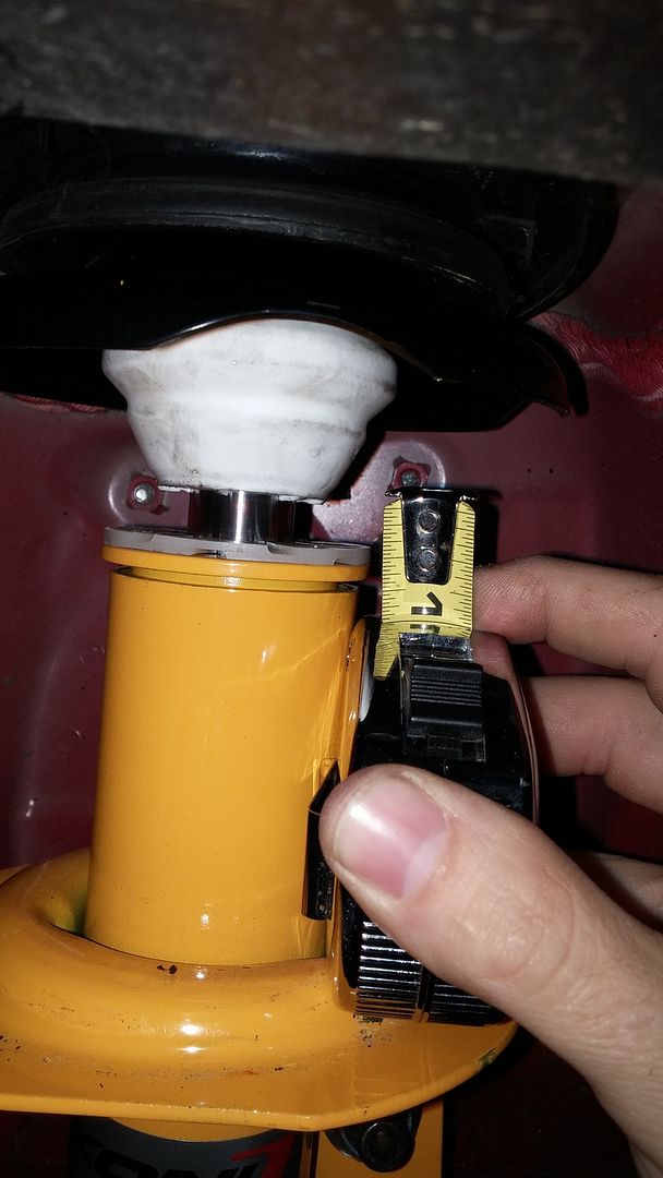

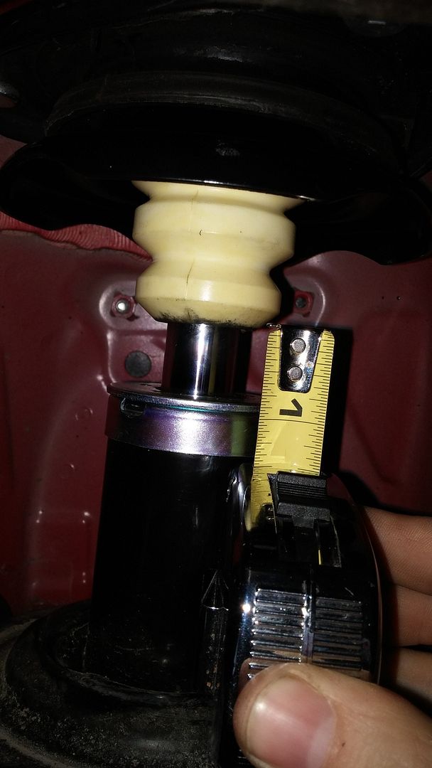

Took some photos showing available front bump travel with oem vs. TRD springs. I used 14 7/16's center of hub to fender for the OEM and 13 3/16's (as measured on my car after TRD/koni install) for the TRD. TRD bumpstops are approx 1/4 inch shorter than OEM.
Oem height and bumpstop.
TRD height and bumpstop.
Thuoght others might be interested.

Wow, that's like Miata territory. Riding on the bumpstops all the time I would imagine.

very interesting indeed!
can you confirm your method for leveling the car since obviously the spring is missing.
did you just use a jack to maintain a level?

Yep, just a jack under the lower control arm.
