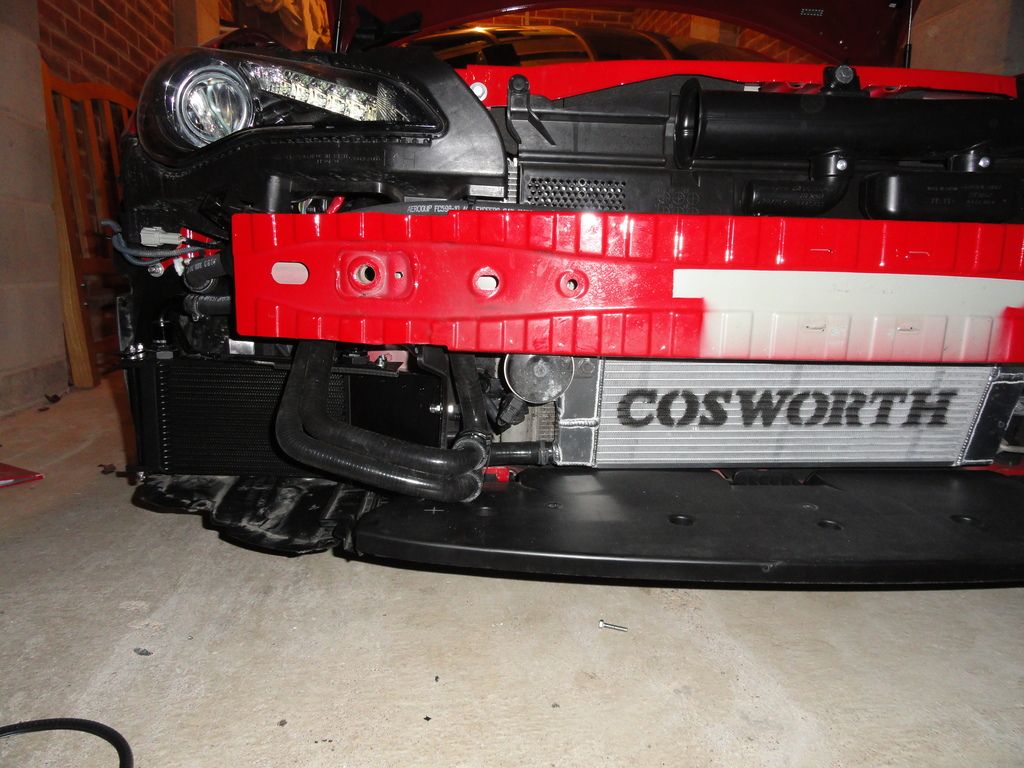

Originally Posted by muckypuppy View Post
Perhaps locating the cooler core in your drivers side fender well with a shroud to bring direct airflow similar to the KateCool setup may help with overcooling? Seems like you need my core and I need yours lol !
My oil cooler is mounted on the driverside fender, right behind the fog light. I made a little airguide.
