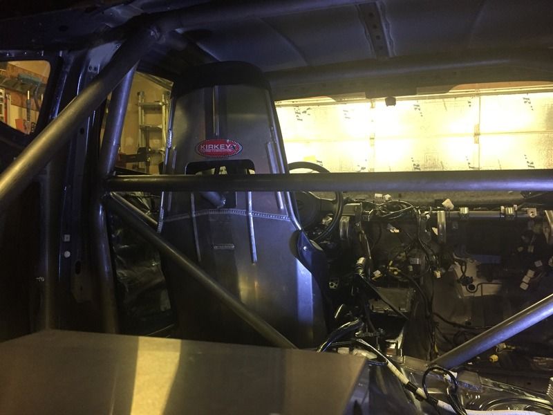

Waiting for valve keepers to arrive then the head will be done at the machine shop. Should have the motor all assembled next week. Bringing the car to the shop this weekend to get the kirkey's mounted, and to pull the interior in preparation for the 10 point nhra cage. Car is going to a buddies shop for that at the end of the month. In the mean time, I've just been playing around with trinkets

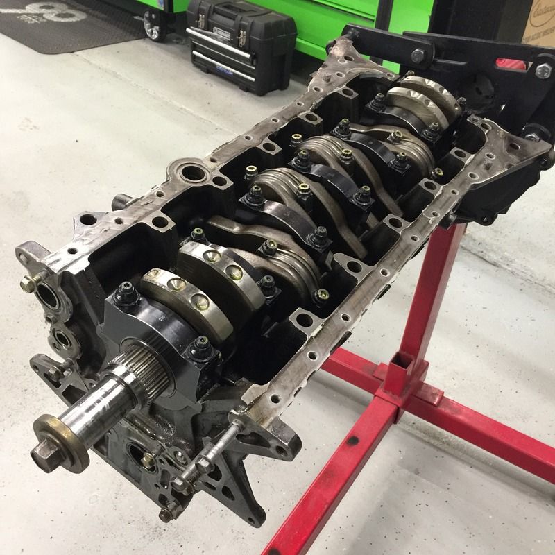

Manley turbo tuff rods with arp 625+ hardware
Cp 10:1 pistons with upgraded wrist pins
Arp main studs
Titan billet mains
Titan modified oil pump

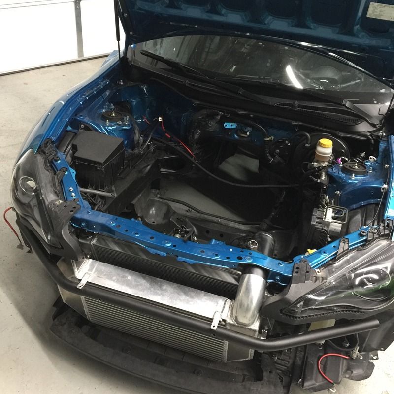

Got the head back. Hks 272's, Manley valves, beehive springs, retainers and keepers. Cleaned, decked, valve job and shimmed. Installed last night, just need to set the timing and install more things tonight.

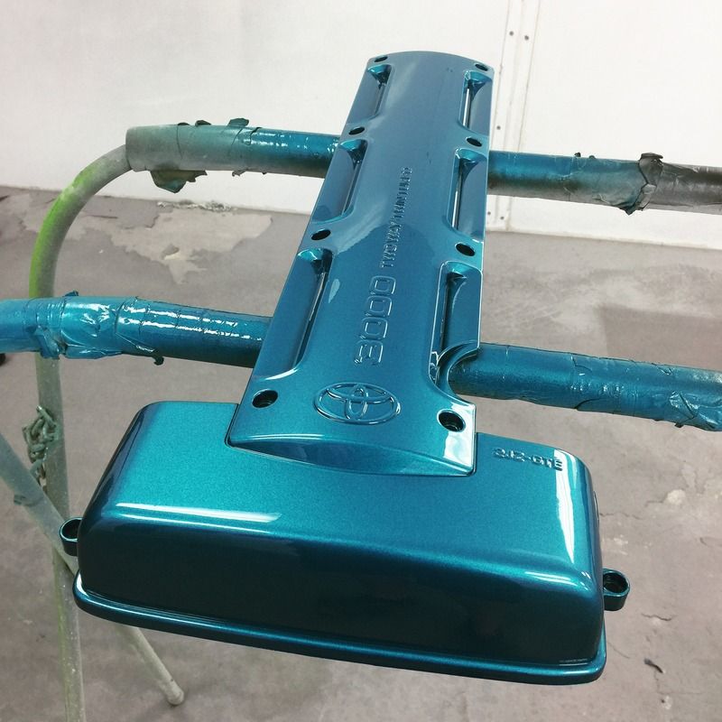

photobucket is being a piece of crap, so im switching to flickr now. still need to weld the new plate for the DBW throttle body and powdercoat the manifold and fuel rail again. for the most part, the engine is complete.

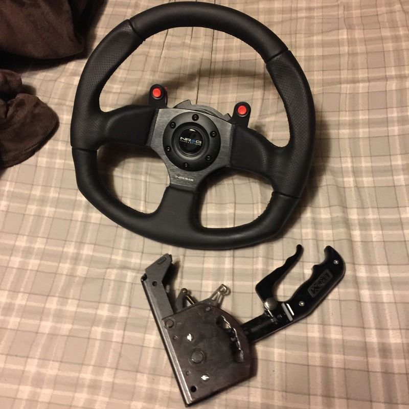

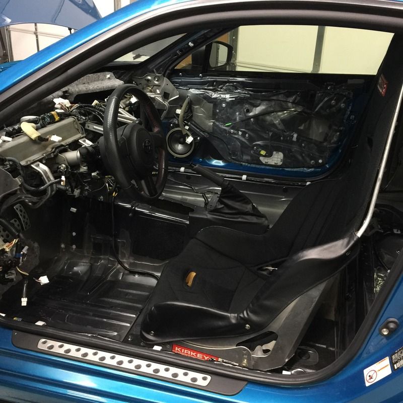

Car is still getting the cage done. Collecting parts still. Quick release steering wheel with trans brake/bump box buttons, B&M magnum pro shifter

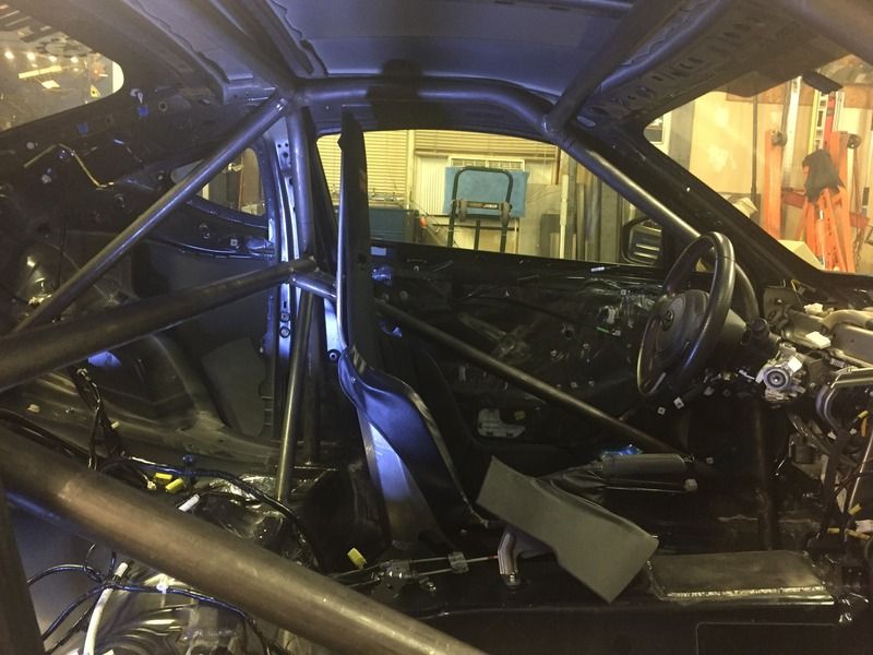

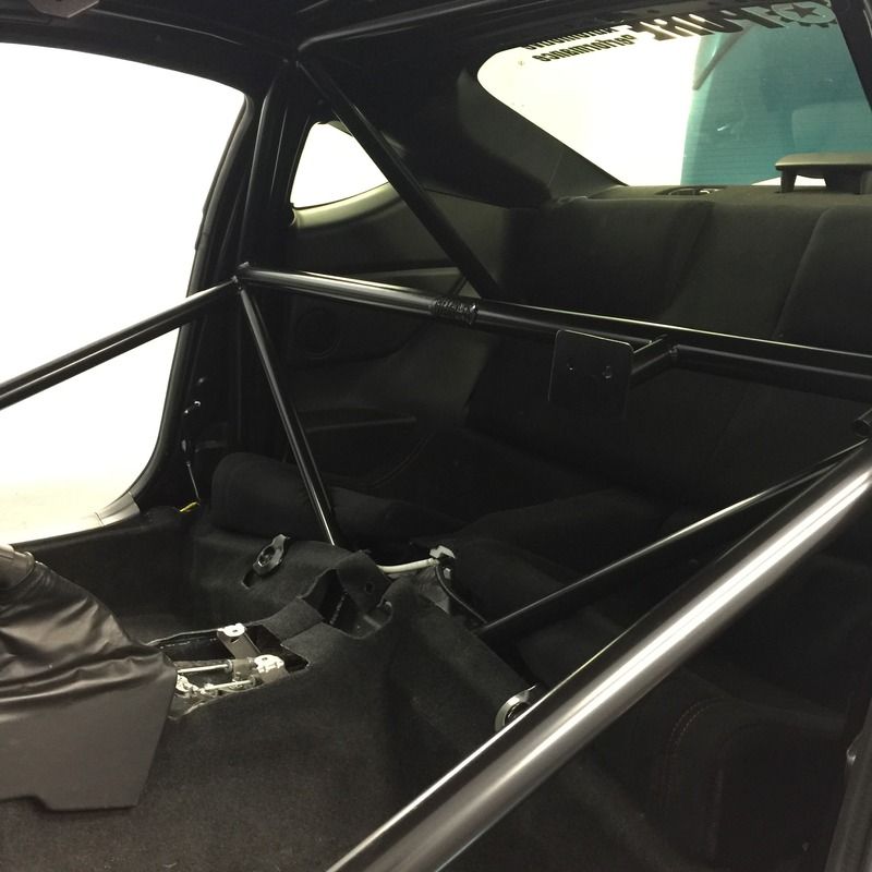

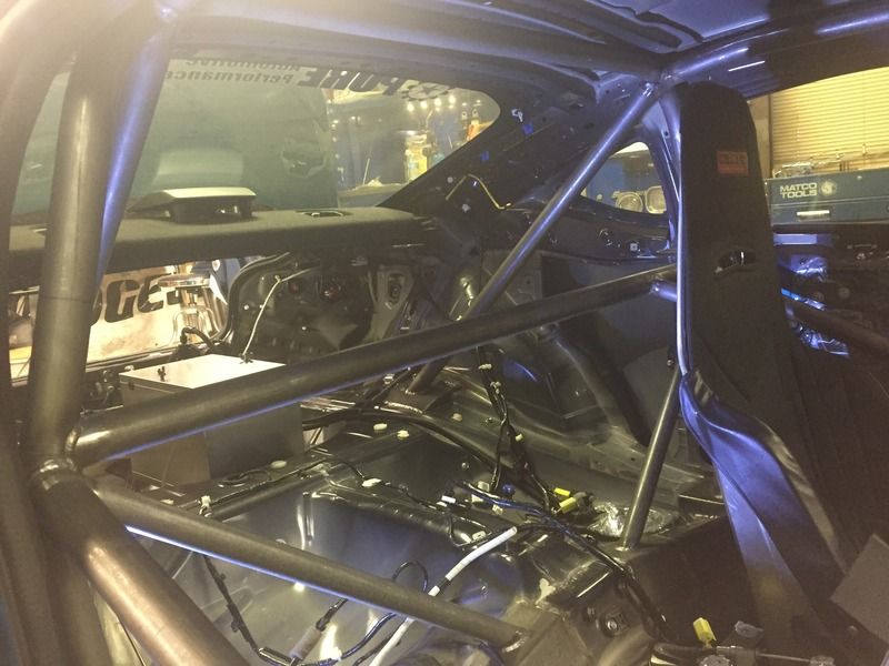

Cage is done. Should be able to pick it up this weekend then I will weld in the window net and parachute release lever where I need them. Then paint and reinstall the interior

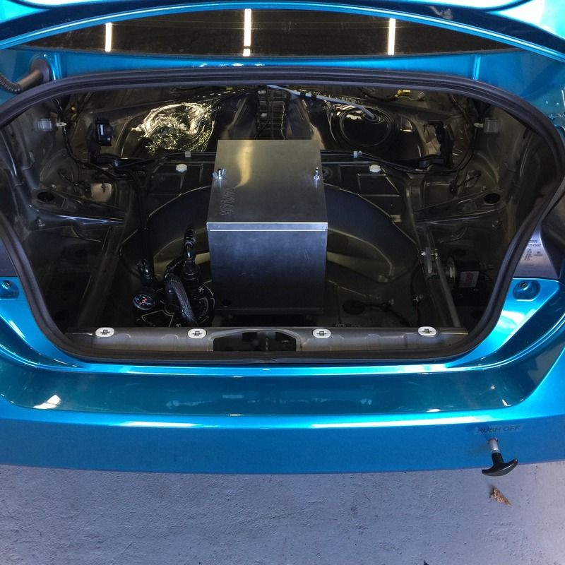

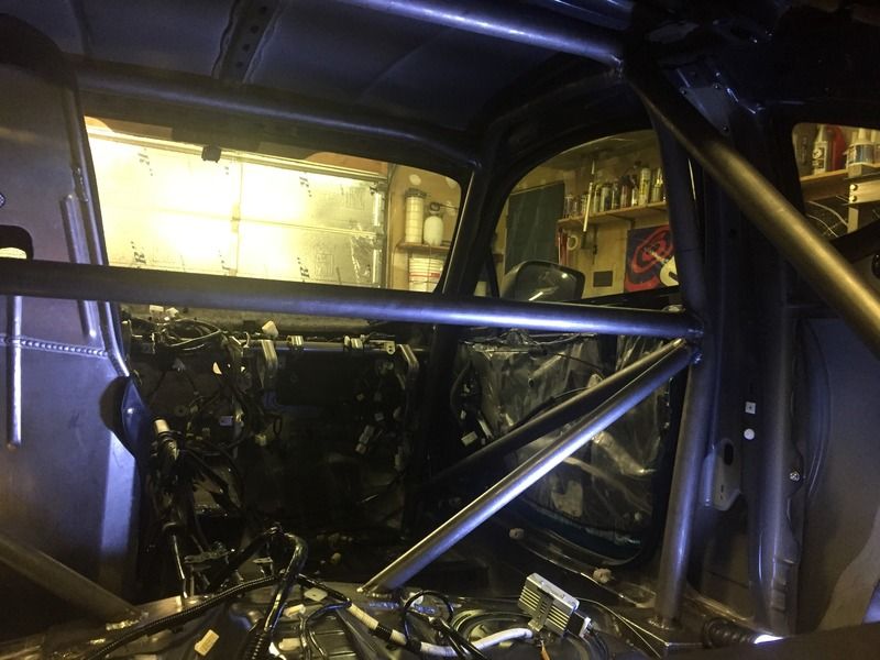

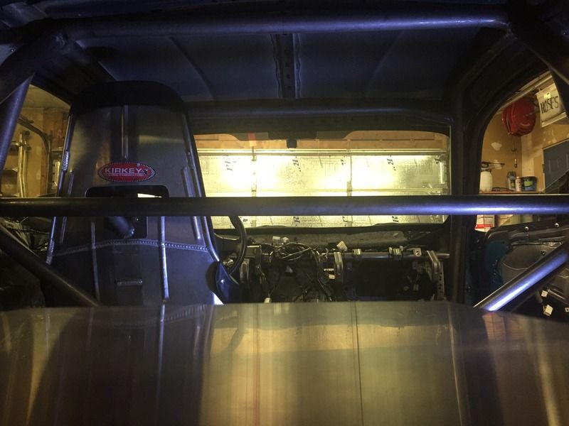

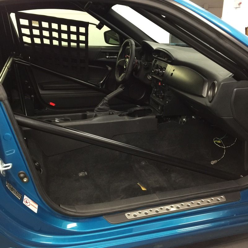

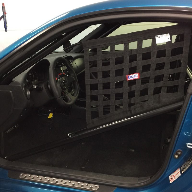

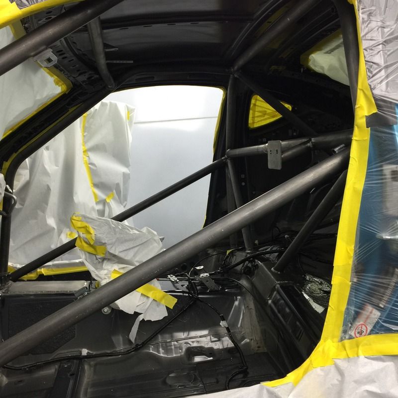

Progress so far

Did u guys cut holes in the floor to lower the cage and weld the top part of the piping near the roof?
Toyota - Making Dreams A Reality
461hp on 91octane - JDL turbo GTX3076r GEN 2 - Mazworx CD009 transmission
Kris86 is offline   Reply With Quote
Old 11-21-2016, 12:20 PM   #294
spitfire481
spitfire481's Avatar
Drives: 2JZ FRS
Posts: 1,378
Thanks: 97
Mentioned: 27 Post(s)
yes, it was dropped to give room to fully weld, then raised up and the floor plates/boxes were built
