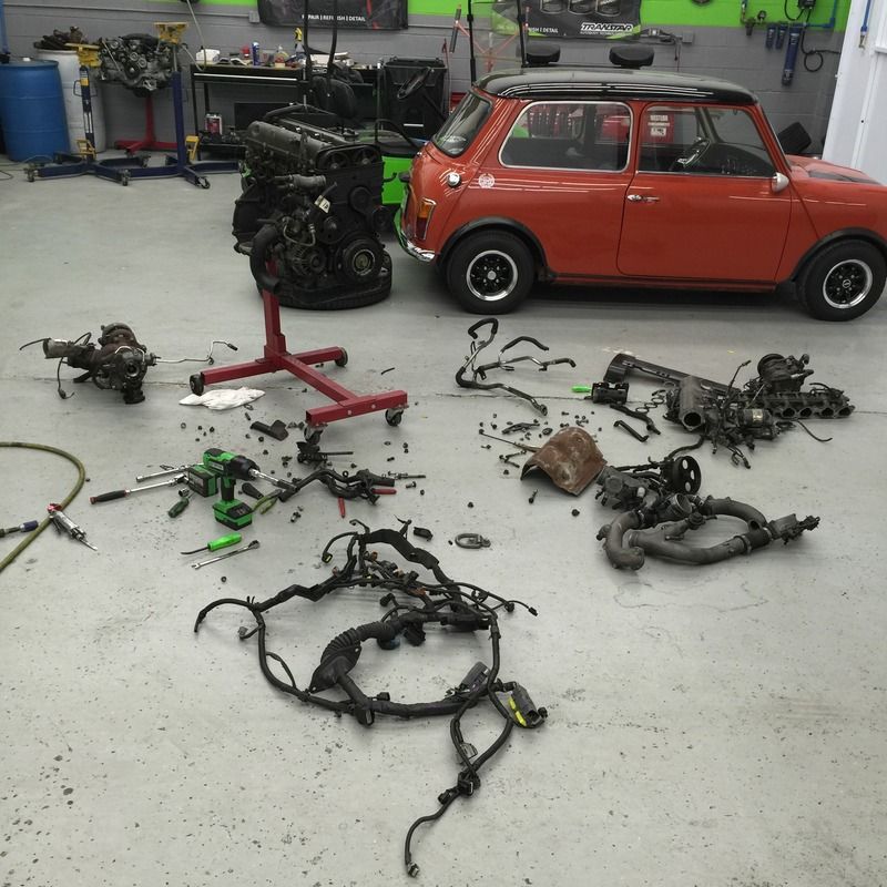

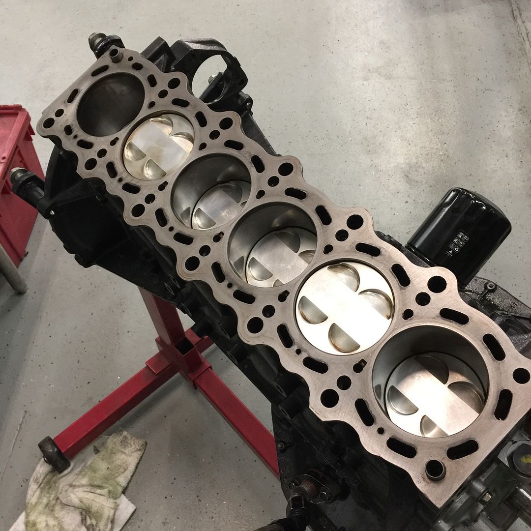

Starting to get somewhere now. So we used my jdm 2jz block as a donor for the green shop Frs. Finishing up a half fill and aluminum rod setup on that block right now. Pulling the head off of the current drag car block to swap to the new one, then the current drag car short block is mine. Saves us down time for the shop car, and saves me some machine costs and time as well. So currently for this car I have a fully built short block with billet mains, turbo tuff rods with arp 625 hardware, JE 10:1 Pistons, arp main and head studs. Just need to get the stock 2jz head cleaned, decked and it's ready to drop on with valve springs and hks cams.

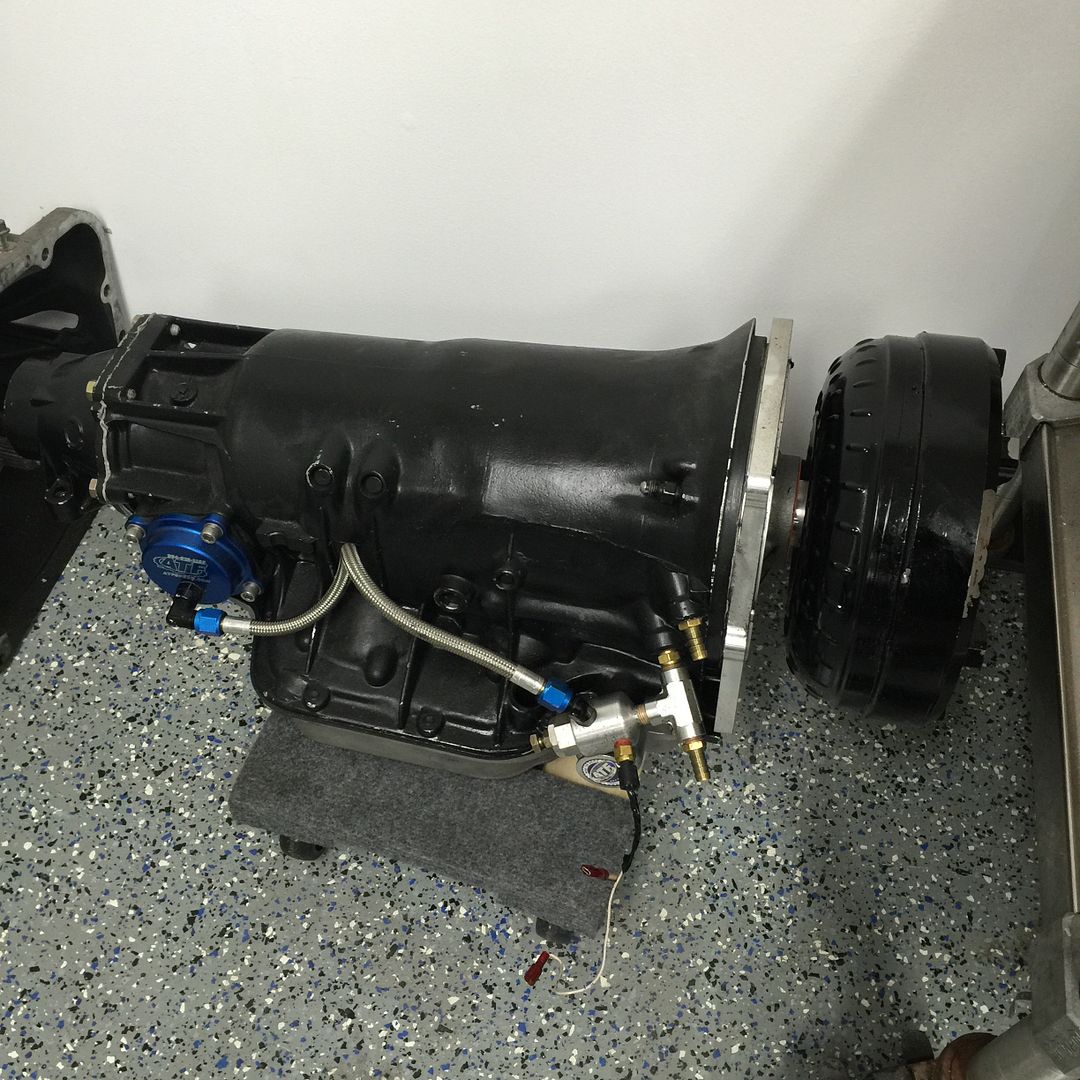

Also have the ATF speed th400 with 2jz bellhousing setup. Hybrid converter with pressure bleed off valve and trans brake

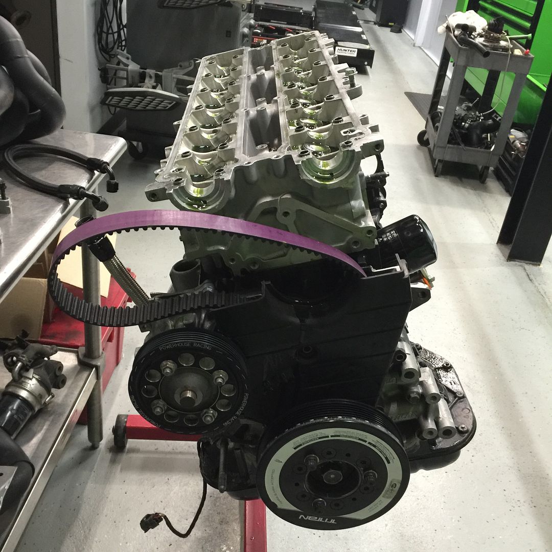

Still looks mint. My head is at the machine shop getting a valve job, decked, and gsc beehive springs installed
