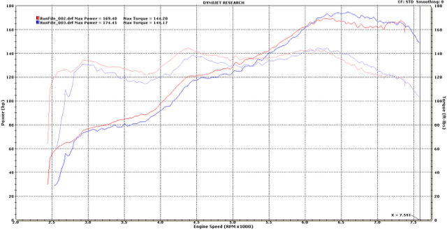

The blue line is with crawford's stage 1 91 octane tune, BPB, drop in filter, perrin inlet tube, catless uel, FP, OP, and cat back.
Red is the same but with perrin's bigmaf, and flex fuel running e67
Def a loss of power at the top end but a good gain everywhere else
