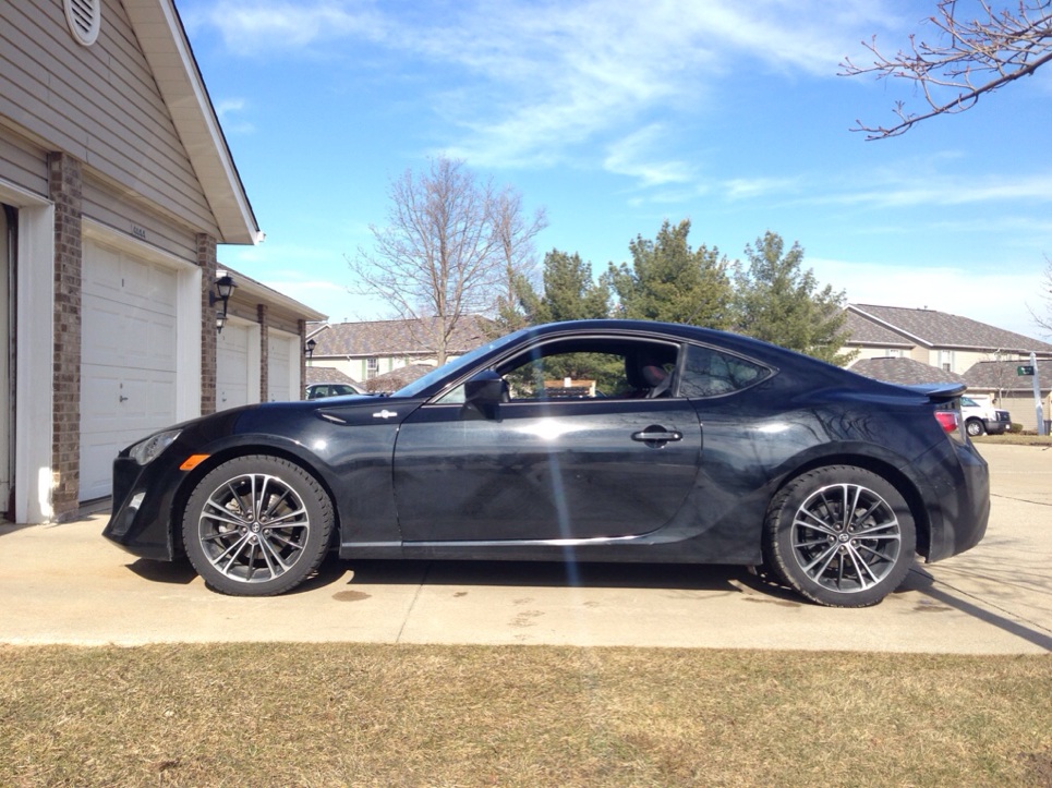

Originally Posted by Steve View Post
Looks subtle, less than an inch for sure, which makes sense. They probably wanted it subtle enough that alignment parts for the back are not necessary. From experience lowering an inch (swift springs) brings the rear camber to about -2 degrees, which looks quite sunken in with stock wheels.
Yup, I'm at about -1.5 deg in the rear and the install instructions only tell you to adjust toe and that the change in camber is okay and still in spec

Originally Posted by nosidda9 View Post
Before:
Attachment 71216
After:
Attachment 71217
Sorry it was bad lighting on the after pic
How long did you have the springs installed for the after pics? Sometimes it takes a while for springs to settle. Any updated pics? thanks
I uploaded a new after pic to my original post, it's sunny out and you can tell the drop difference much more easily. Also the new pic is with about 100 miles on them and the drop is still under and inch
